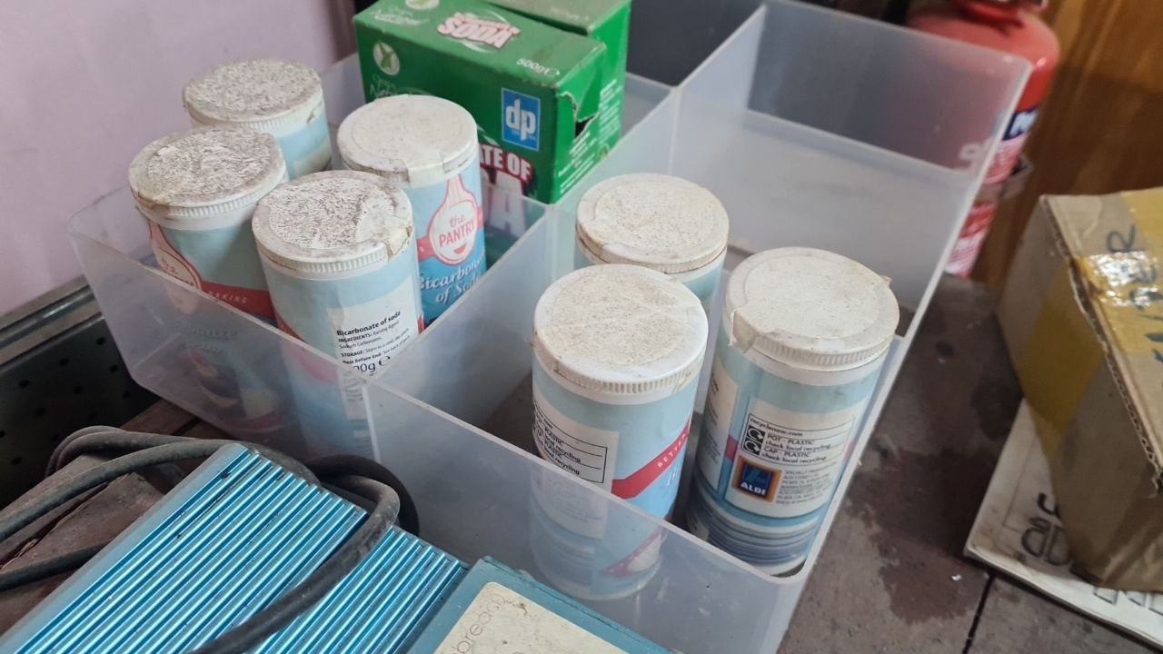

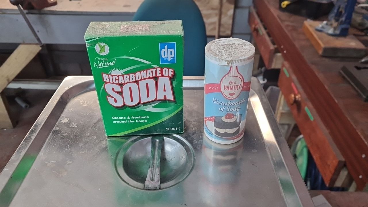

BiCarb
The main ingredient other than water is Bicarbonate of Soda.
Note Baking Powder should be avoided since it has other things in which interfere with the process.
- 6 Litres of water = 40ml of Bicarbonate of Soda
- 5 gallons of water = 1/2 cup of Bicarbonate of Soda
- 2 gallons of water = approx 1/4 cup of Bicarbonate of Soda

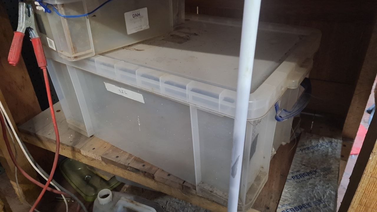

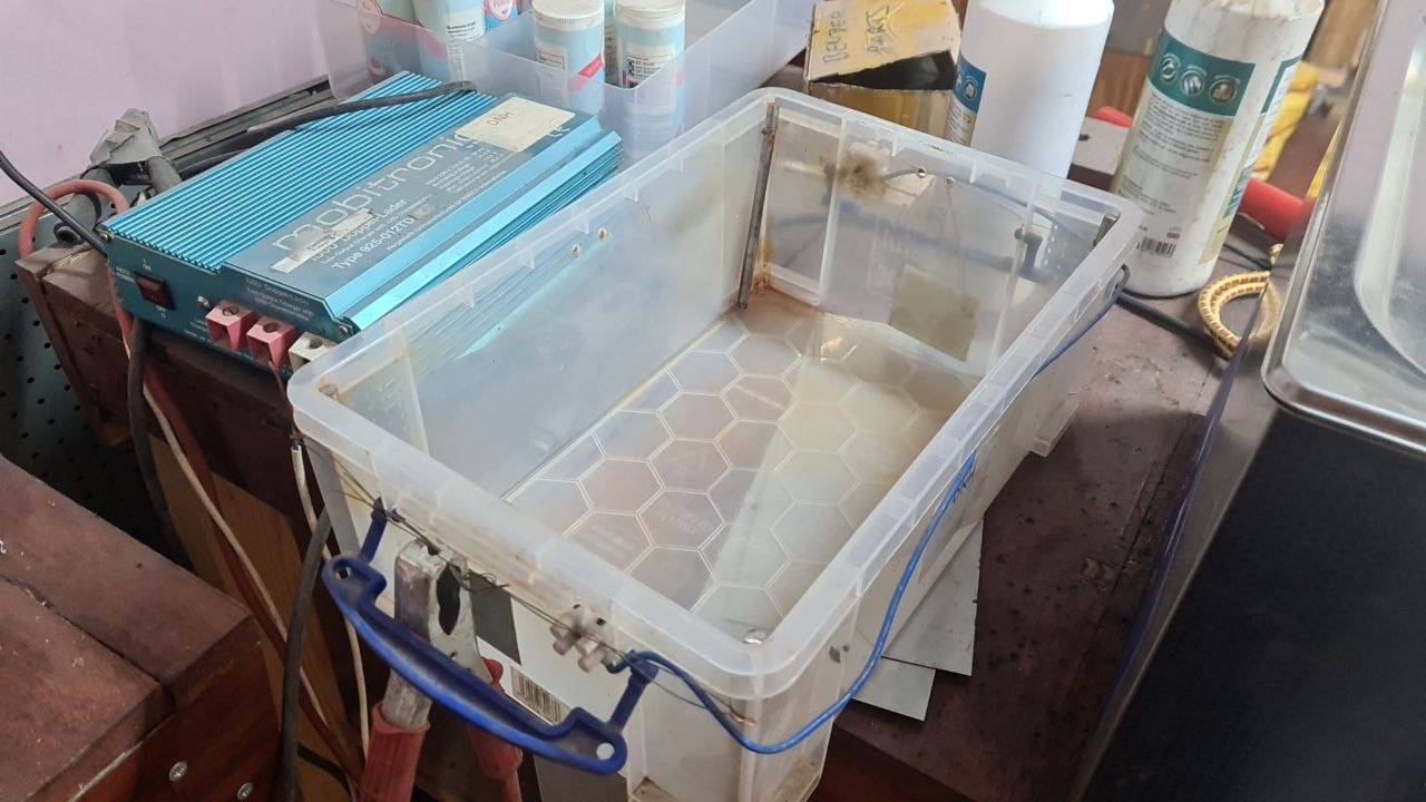

Tanks

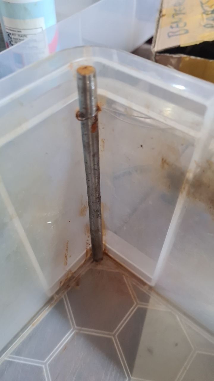

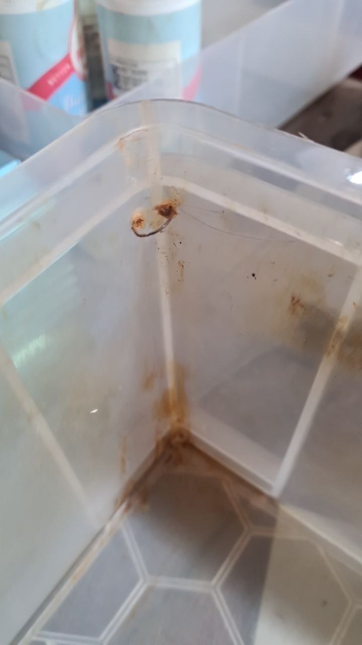

Currently we have two tanks. These are basically really useful boxes that have metal rods at each corner wired up with welding wire.
Electrodes
There are 4 metal rods one at each corner of the tank with a wire loop around the top. This makes the rods easy to take out and cleanup if they accumulate too much rust as part of the process

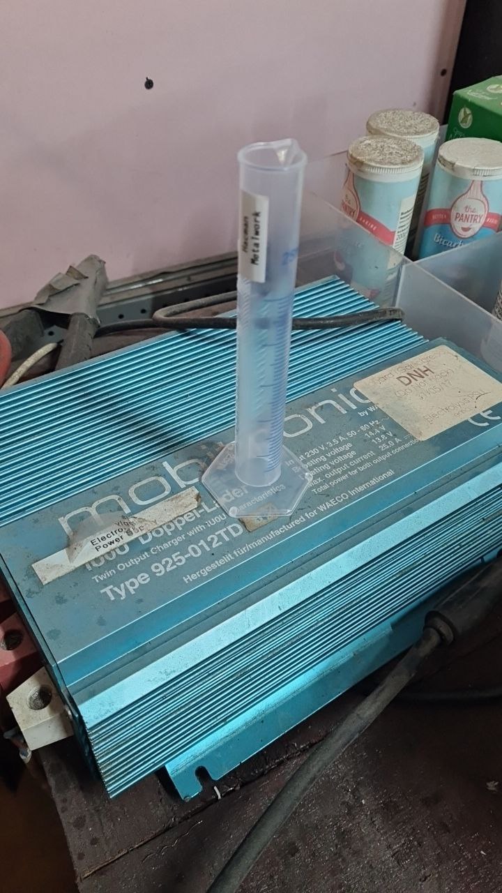

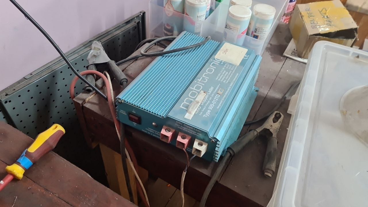

Power Supply
The power supply is a fixe 12V car battery charger, this is able to supply a lot of current at a fixed voltage so is good for this.

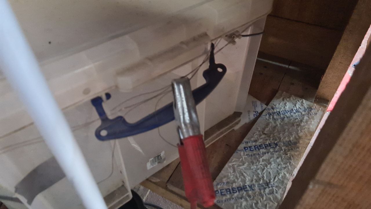

Cabling

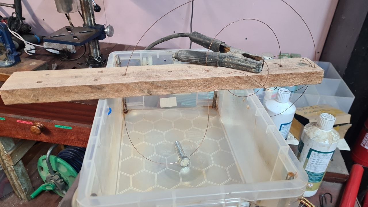

The positive or red clamp should be attached to the outside of the tank
The negative should be attached to the part With the below this is actually a block of wood with some welding wire running through it.
