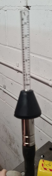

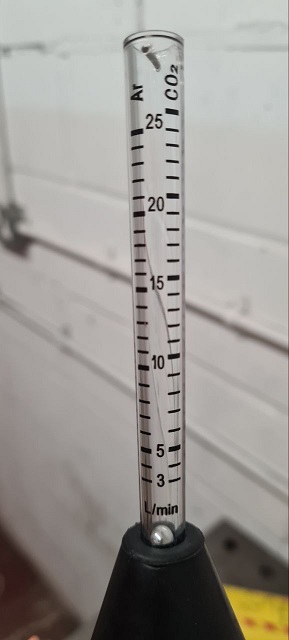

One of the ways we can test the flow rate of the gas through the welder is the use of a peashooter gas flow meter that fits onto the end of the nozzel
The typical flow rate for Mig should be around 15-20 litres/min Our current reading is 19

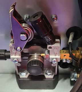

Disengaging the wire feed
In order to avoid wire being fed from the Mig nozzel
We need to disengage the wire feed.
(Make sure the machine is off while doing this)
Before
After
Measuring the the Flow
To measure the flow place the meter upright on the end of the nozzel and depress for gas while in Mig mode.
