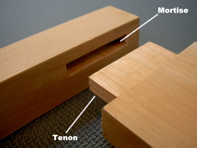

Blade is perpendicular so can be used to cut mortises etc.

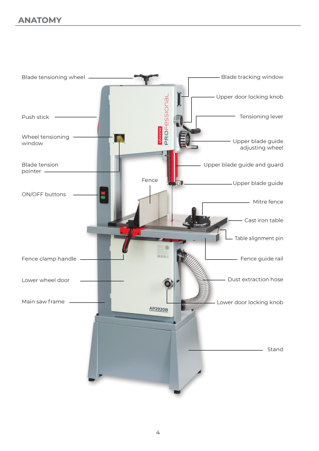

Axminster AP2920B
Please see the diagram for this machine below. Note in particular that on this model there is a window to enable viewing of the bandsaw's tracking. As this machine has dust extraction always connected and a window for viewing tracking it is requested users do not open the case.
The blade guard may be raised and lowered with the
Review the Axminster AWHSBS250N manual for further queries.
