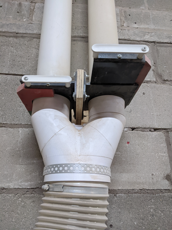

Main branch by dust extractor
There are two central branches from the dust extractor.
You must ensure that the branch leading to the machine you're using is open at this divide. The baffles are colour coded to show whether the baffle is open or closed. Green means open, red means closed. In the picture above, the right hand branch is open. You may open both branches if necessary.

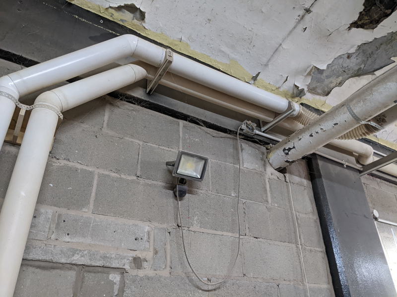

The branches go to different parts of the workshop. They are labelled, but if you are unsure, you can follow the pipes. Here, you can see two branches on the ceiling:
Follow the pipe to the machine you are using and ensure any intermediate baffles are open and baffles for unused paths are closed.

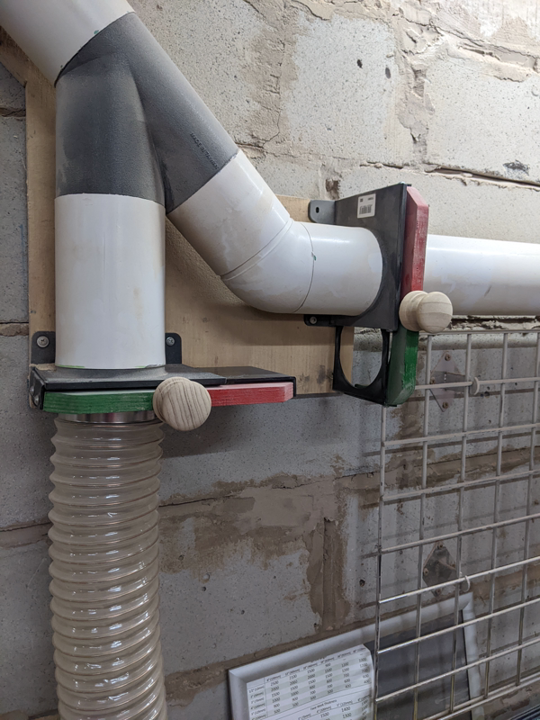

Branch next to lathe
At time of writing, the branch below goes to either the large bandsaw (down) or to the table saw or the free pipe (to be used for mobile tools). In the picture shown the path to the table saw is closed and the path to the bandsaw is open. Please ensure only one route is open.

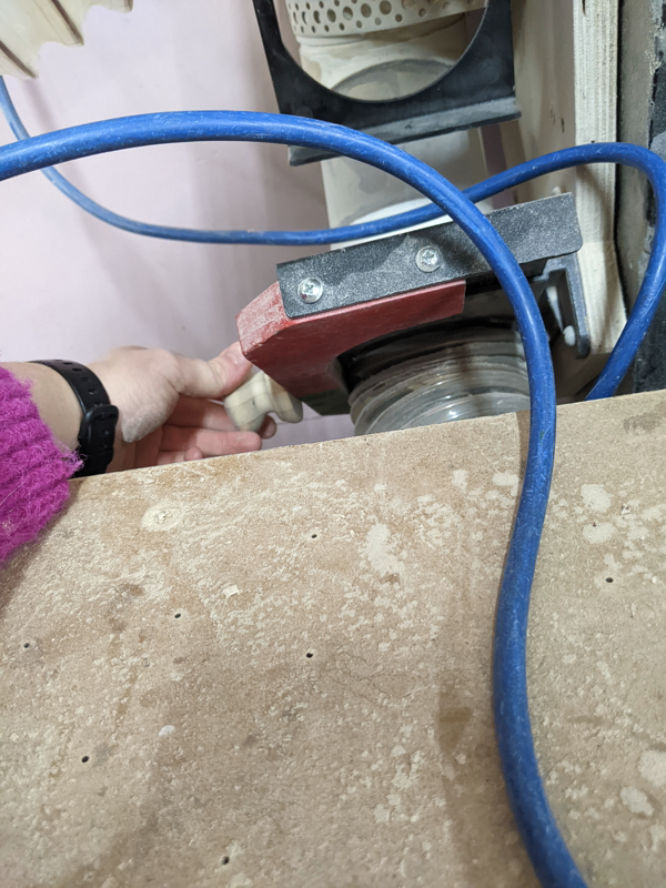

The baffles use a simple sliding motion. See the baffle being opened:
and closed

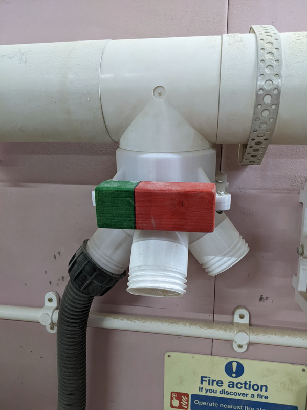

Baffles at individual stations

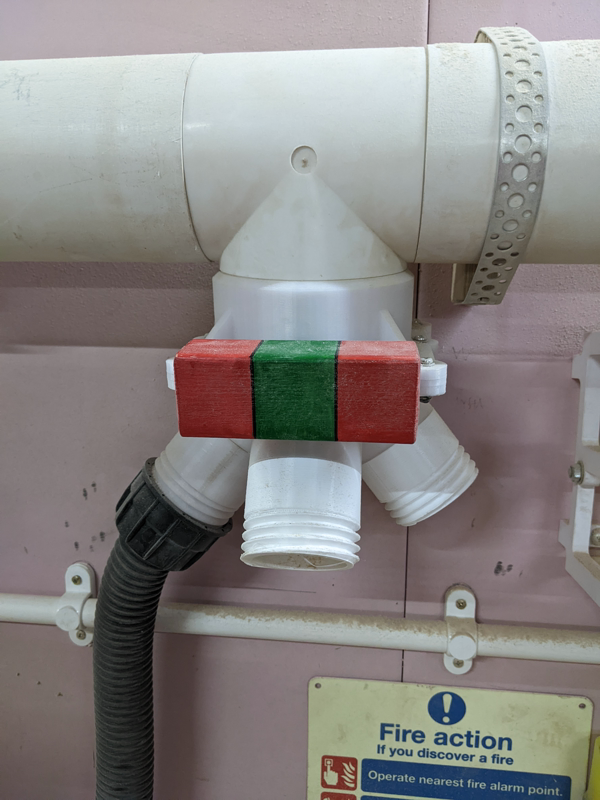

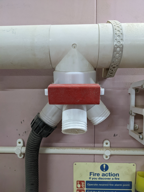

As well as the larger pipes, the dust extraction also has three way outlets over workstations. The baffles here are similarly colour coded to the larger baffles; but selecting which pipe to use is dependant on placing the required baffle in the slot. Baffles at the station can be pulled out as shown:
You may use these baffles to select a route for the extraction:
All pipes at workstation closed
Left hand channel at workstation opened
Middle channel at workstation opened
