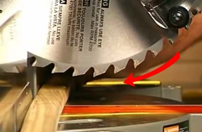

Blade teeth pointing the right way
Ensure mitre teeth are pointing towards the back of the machine
