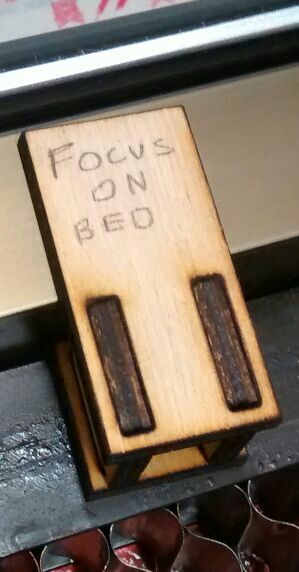

  1. Introduce the laser cutter and point all the functions i.e. the bed size, where the cooler is, the extractor fan, menu selector
  2. Make sure the coolant pump is on (mention recommended temp [25 or below] and it should come on automatically if the laser cutter is on)
  3. Talk about the emergency stop, water, fire extinguisher, fire alarm and when you should use them
  4. Open the cover. Mention the different parts, laser head, mirrors, lid switch for laser cut off (don't tamper with safety features)
  5. Autolevelling and manually moving the bed with bluey (note the limit switch and how a material should be placed for it)

  • For cutting materials up to 6mm it's best to have the z height set to bed level.
  • For cutting materials over 6mm, try to keep the z height 6mm into the material. Multiple passes may be needed.
  • For engraving set the focal point to the height of the material by placing the guide on top of it.
  • If you want crisp engraving on thick stock, you will need to do a 2-stage engrave / cut with the focal point initially set to the top of your material, and then re-set to the correct height for your cut.
