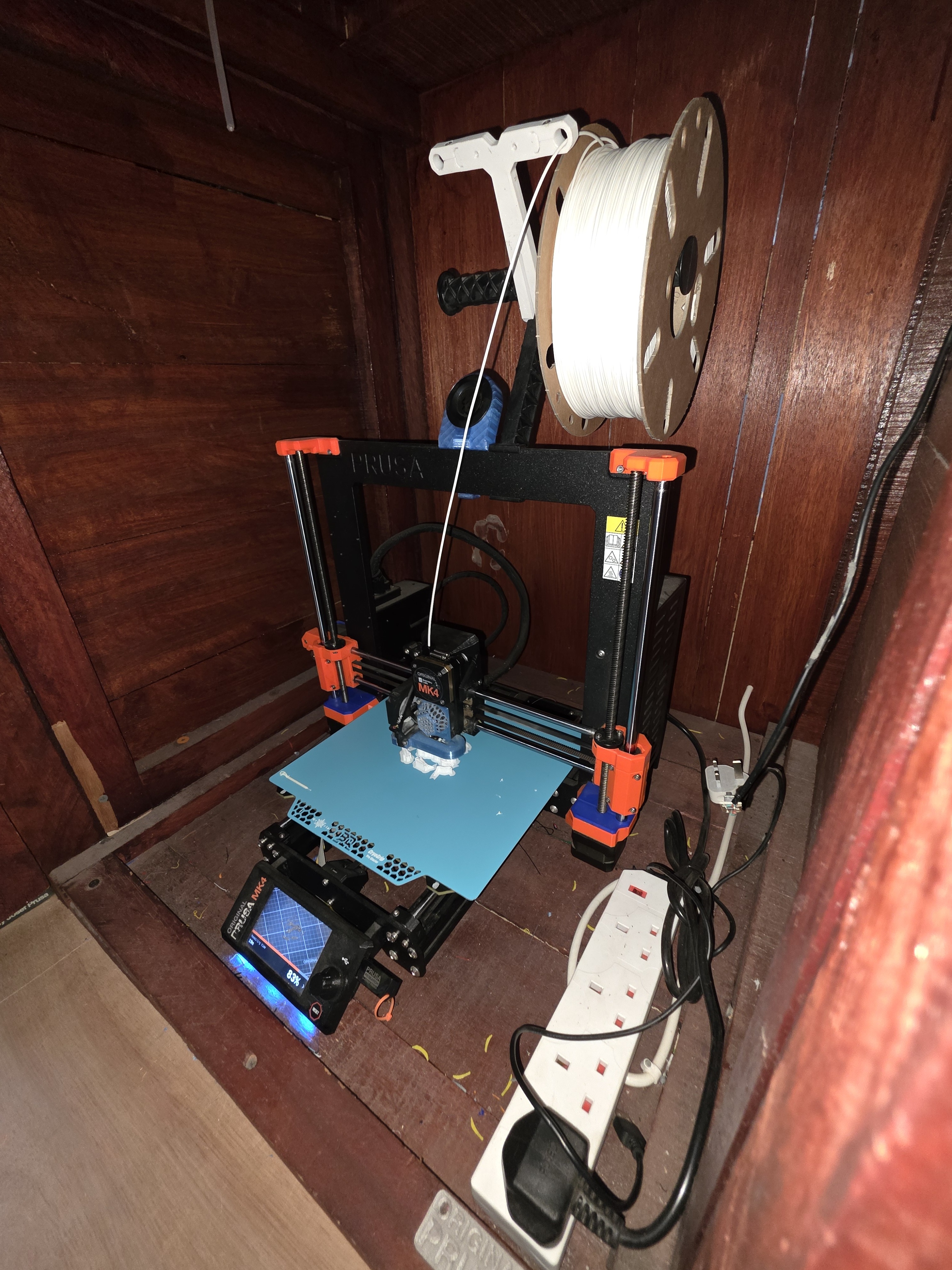

Our printers
HacMan provides:
  • 2 × Prusa MK4
  • 2 × Bambu Lab P2S with AMS 2 Pro
  • 1 × Bambu Lab P1S with AMS 2 Pro
All use 1.75 mm filament and hardened nozzles. Most instructions apply to every printer; model-specific differences are identified where necessary.
Prusa MK4 FDM printer
One of the HacMan Prusa MK4 printers.
Bambu P2S with AMS 2 Pro
A HacMan Bambu P2S fitted with an AMS 2 Pro.
Bambu P1S with AMS 2 Pro
The HacMan Bambu P1S fitted with an AMS 2 Pro.

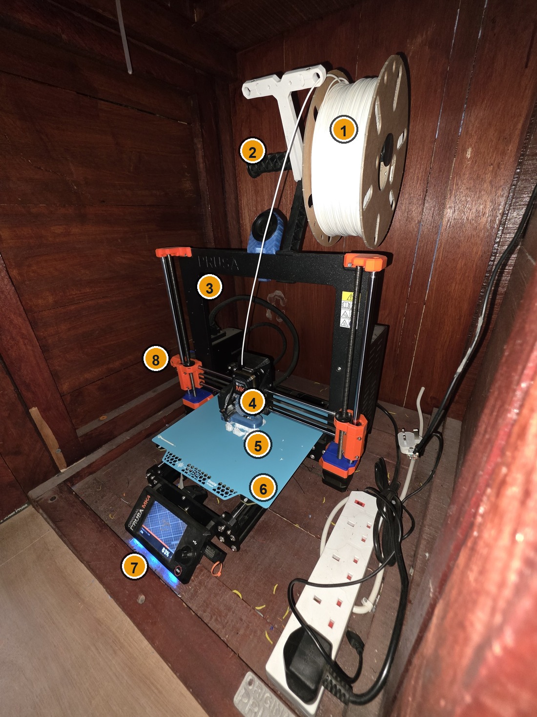

Numbered photograph of a Prusa MK4 showing key printer parts
Key parts of a Prusa MK4. The Bambu printers look different, but the same basic ideas apply.
  1. Filament spool - the plastic filament used for printing.
  2. Spool holder - supports the filament spool so it can rotate freely.
  3. Frame - the main structure of the printer.
  4. Print head / extruder - feeds and moves the filament.
  5. Nozzle / hot end - melts plastic and gets very hot.
  6. Build plate - the removable sheet the print sticks to.
  7. Screen and controls - used to control the printer and read messages.
  8. Z-axis upright - part of the moving frame; keep hands clear while the printer moves.

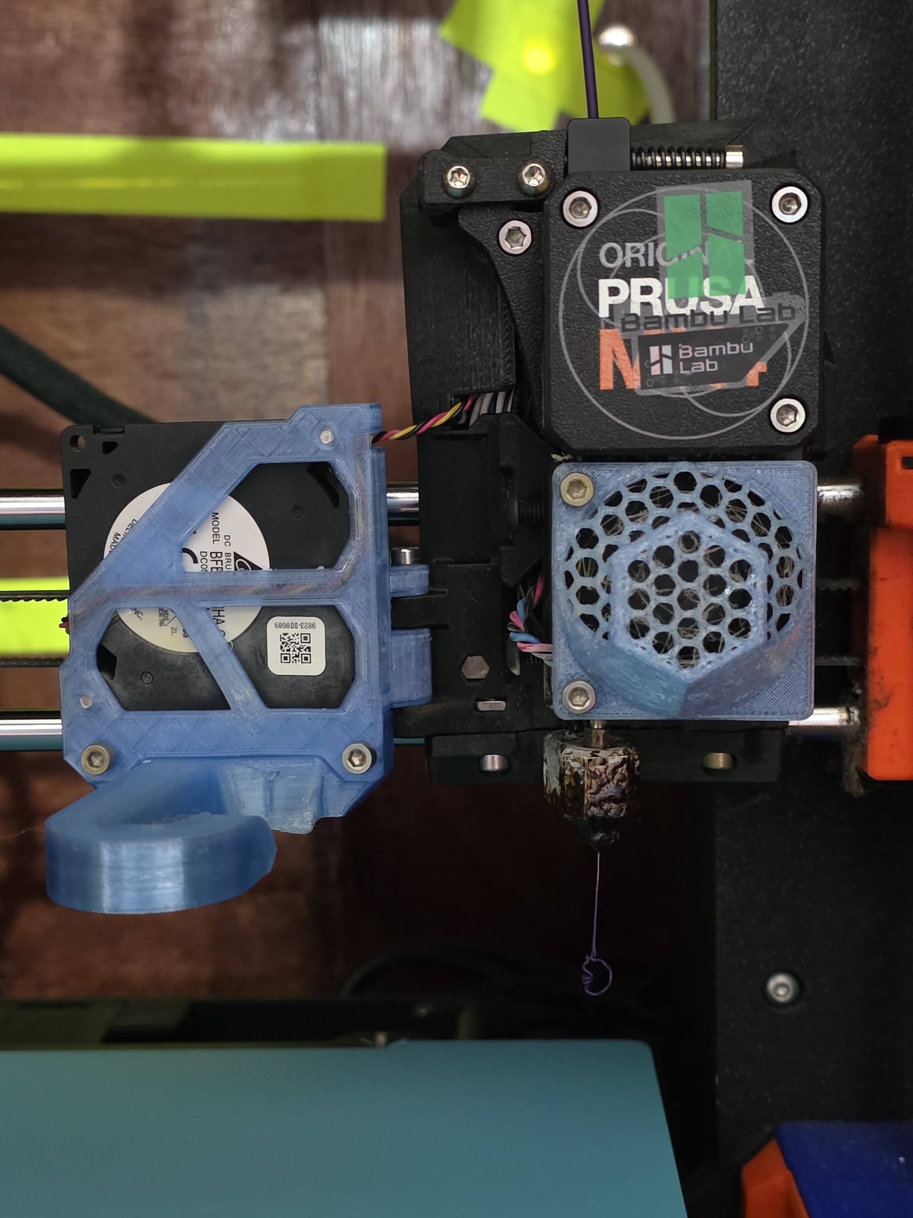

⚠ Warning: The nozzle may reach about 290°C and the heated build plate may reach about 120°C. Never touch the nozzle, avoid touching a hot plate and remember that freshly extruded plastic is hot.
Close-up of a Prusa MK4 nozzle
The nozzle is one of the hottest parts of the printer. Do not touch it.

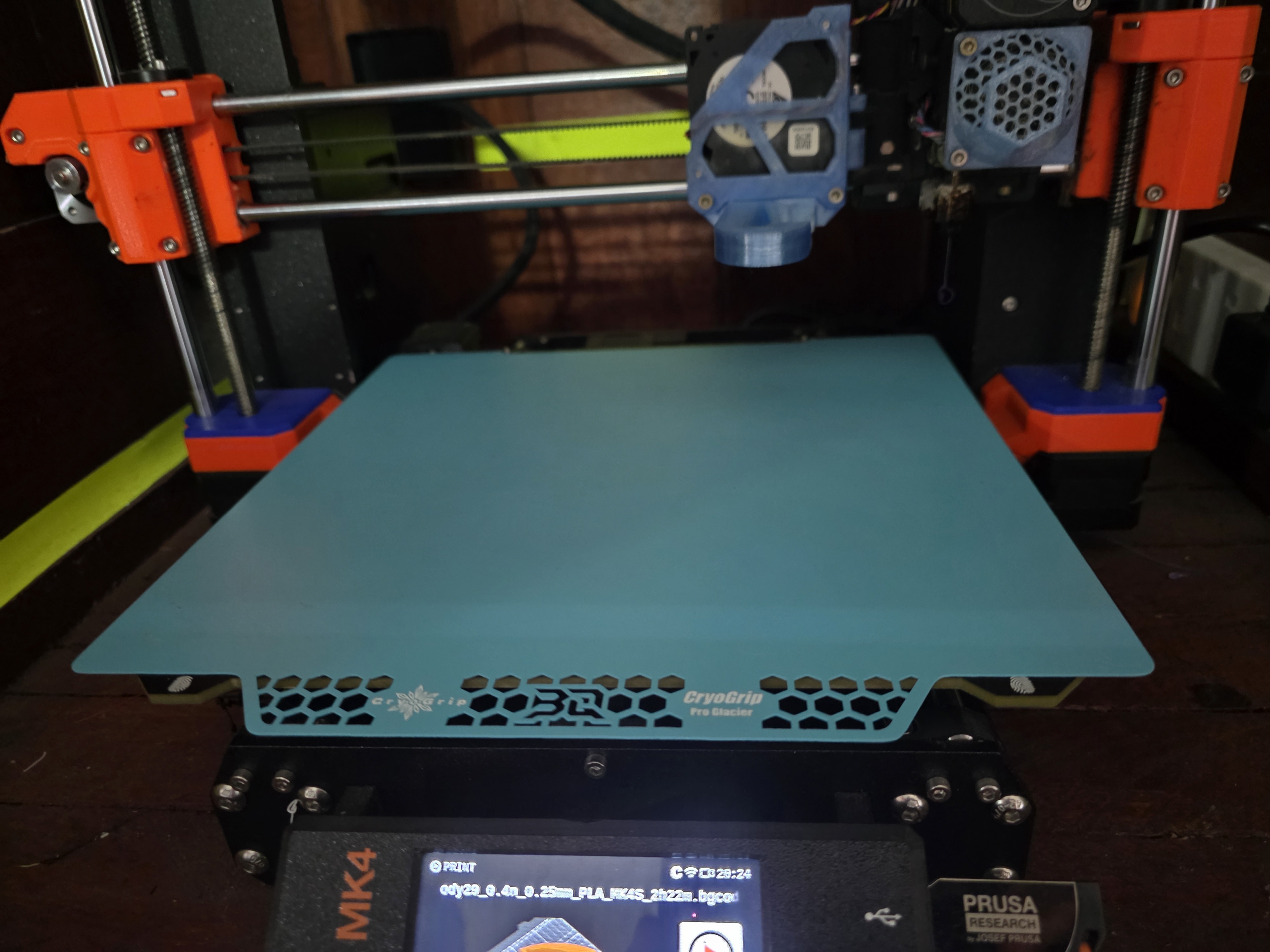

Prusa MK4 heated build plate
The build plate can also become hot during printing.

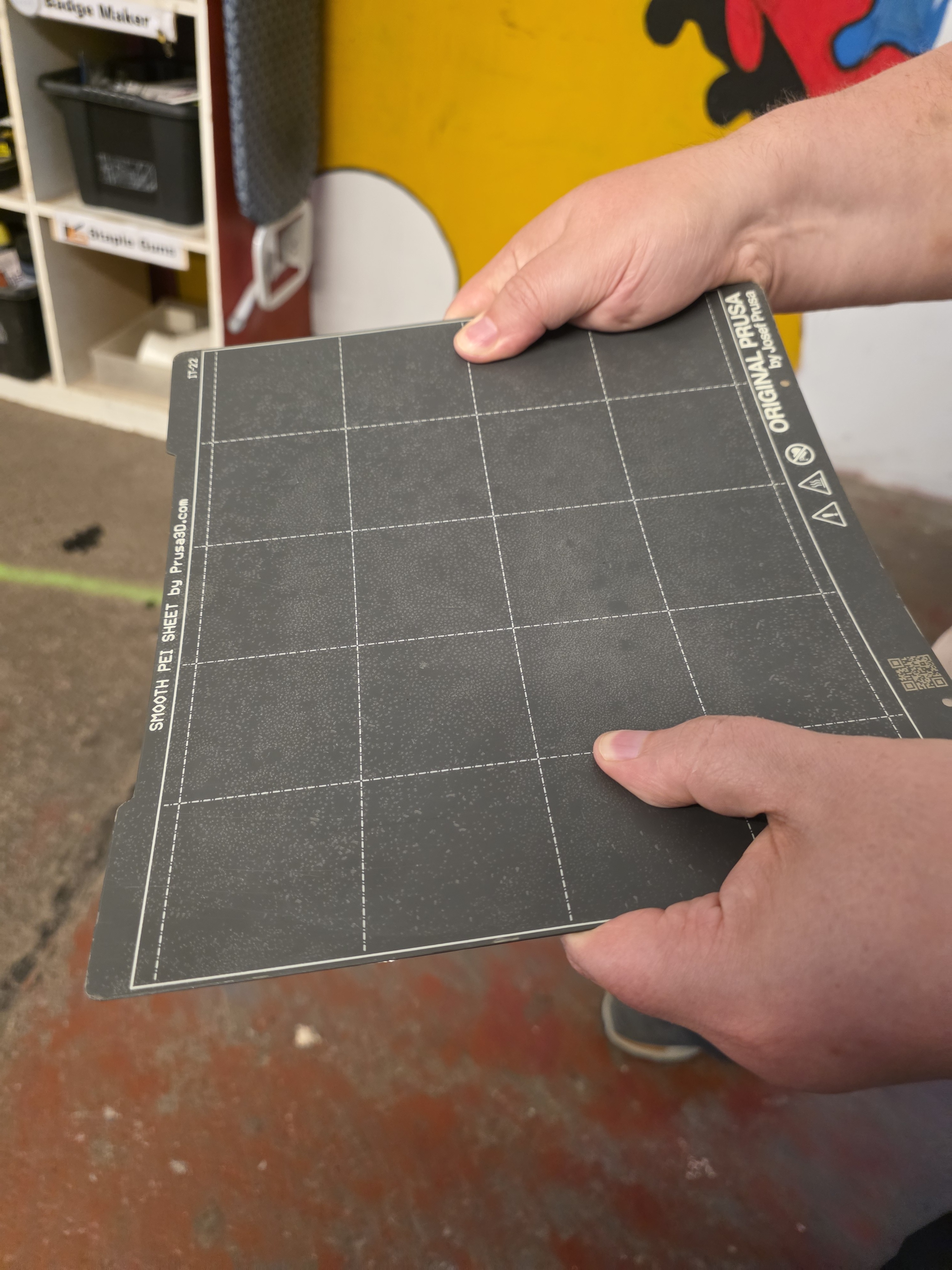

⚠ Warning: Plastic or support material may release suddenly when a spring-steel plate is flexed. Remove the plate from the printer and flex it away from yourself and other people. Consider eye protection for a stubborn print.
Build plate being flexed to release a print
Remove the flexible build plate from the printer before flexing it to release a print.

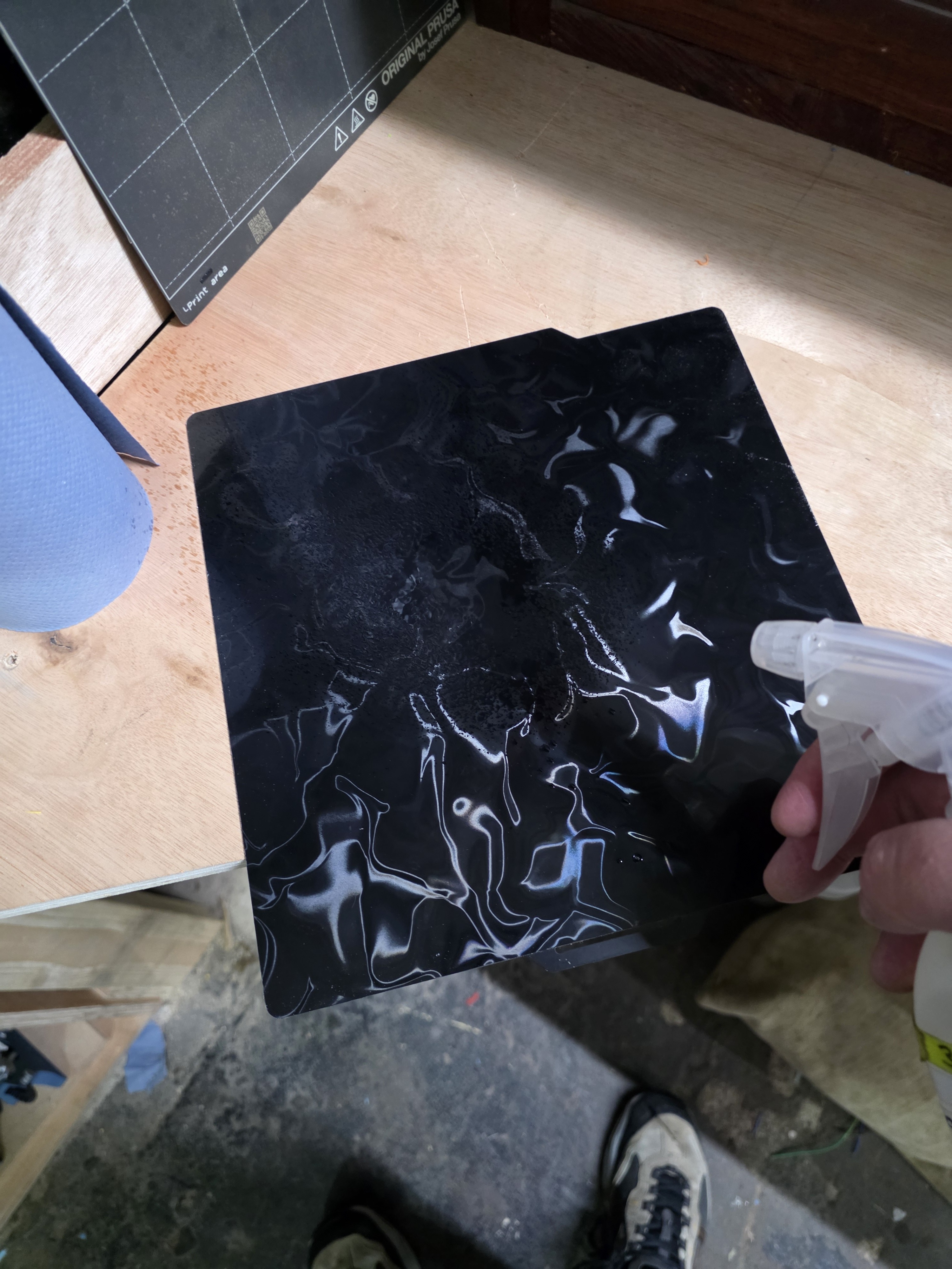

Cleaning the build plate

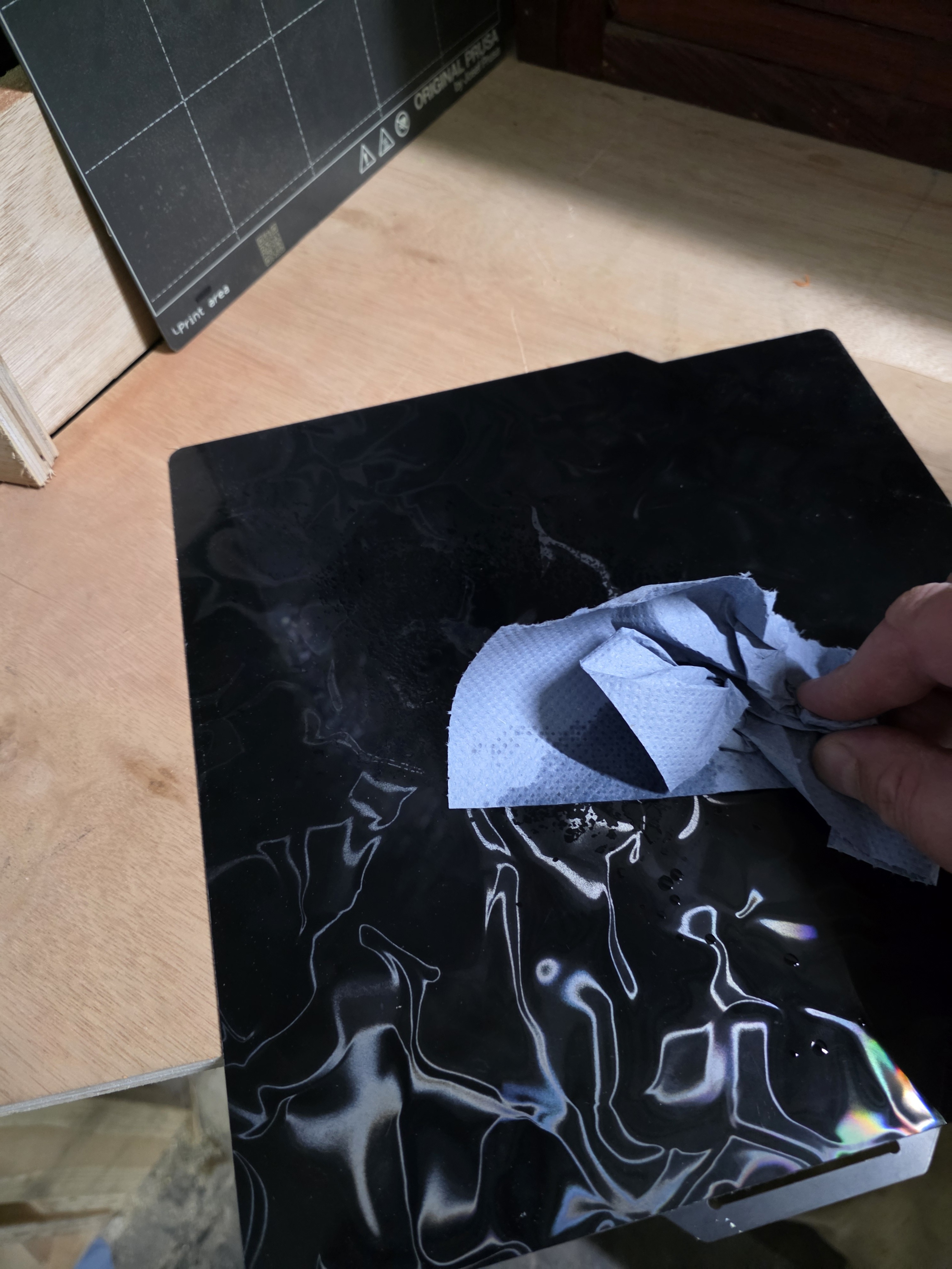

For routine cleaning, remove the plate and wipe it with a small amount of IPA on clean paper towel or a lint-free cloth. Avoid touching the print surface afterwards.
For a deeper clean, wash the removed plate with warm water and washing-up liquid. Rinse it and dry it completely before refitting.
⚠ Warning: Do not clean a plate while it is fitted to the printer and never refit it while wet.
Cleaning a removed build plate with IPA
Clean build plates after removing them from the printer. Apply IPA to the plate or cloth, not to the printer.
Drying a removed build plate
Always dry the build plate completely before refitting it.

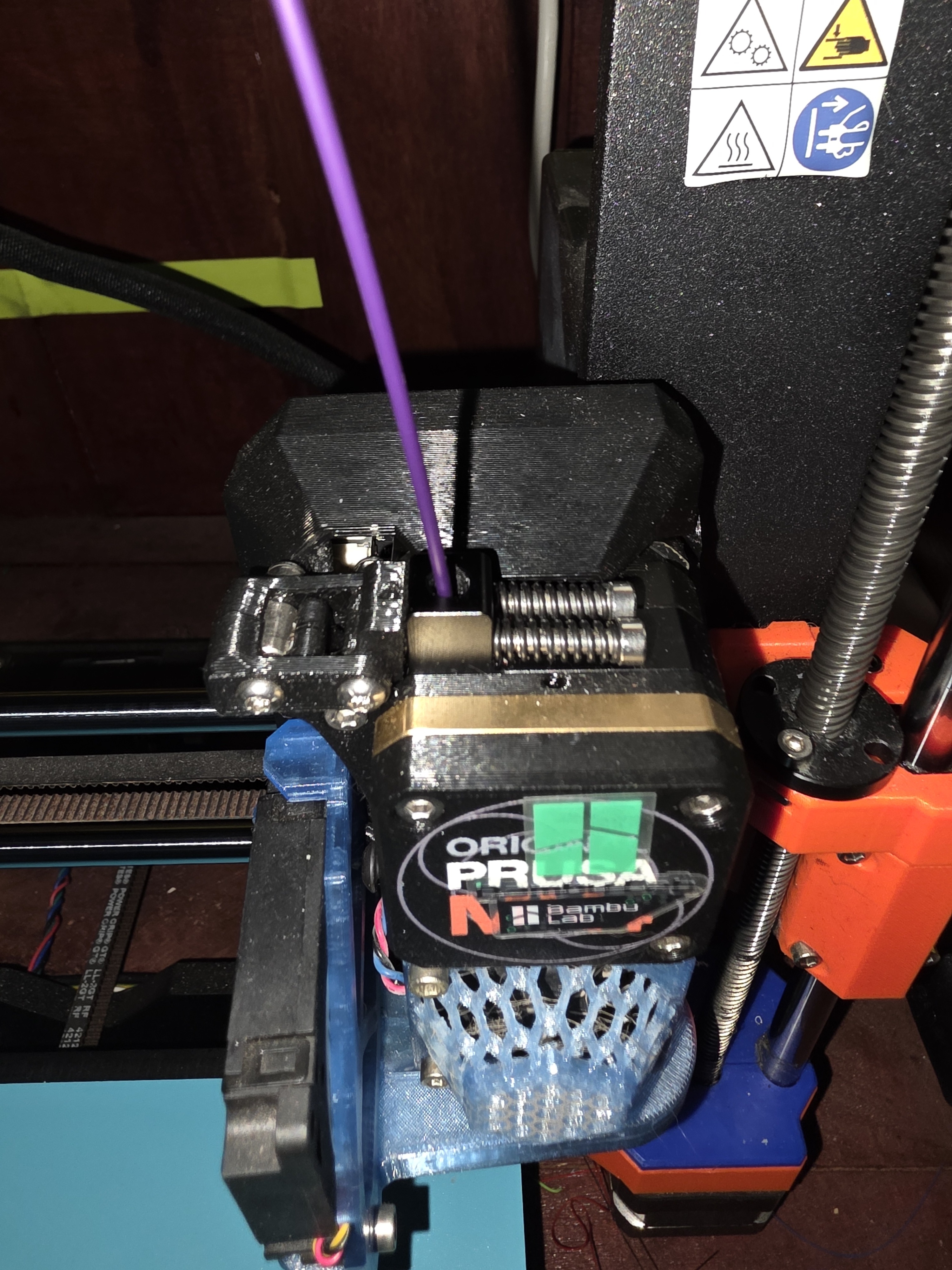

Loading and unloading
Use the printer's built-in load or unload function and follow its on-screen prompts. Cut a damaged or bent filament end cleanly before loading. Feed gently until the printer takes hold; never force it.
On a Prusa, place the spool on its holder and guide the filament into the extruder when prompted. On a Bambu, use an AMS slot or the rear spool holder and confirm the intended source in the print settings.
For more detail, see Using the Prusa MK4, Using the Bambu P1S and P2S and Using the AMS 2 Pro.

Filament entering the Prusa MK4 extruder
Filament entering the Prusa MK4 extruder.

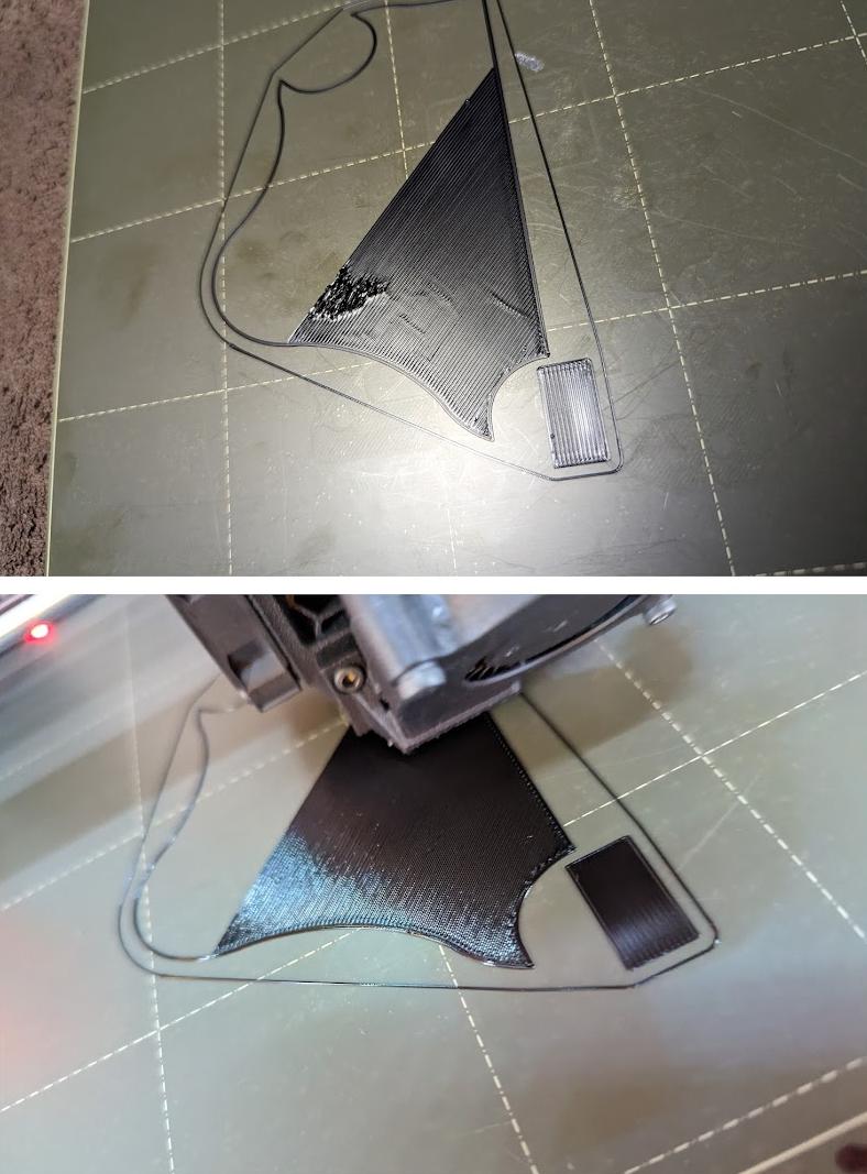

Starting and monitoring a print
Start the job through the printer or supported software. Heating, homing, calibration, bed probing and a small filament purge are normal. Keep hands clear.
Stay beside the printer and watch the first layer. A good first layer has continuous lines firmly attached to the plate with no lifting edges.
Stop the print if:
  • filament does not stick;
  • the print lifts or detaches;
  • filament collects around the nozzle or forms “spaghetti”;
  • feeding stops;
  • the printer reports an error or makes unusual noises; or
  • continuing may damage the printer.
Once the first layer is successful, you may use other parts of the Hackspace, but a competent member must remain present and the print should be checked periodically.
Good first layer example
A good first layer has smooth, continuous lines attached to the build plate.
Poor first layer example
Stop the print if the first layer is not sticking or is dragging badly.

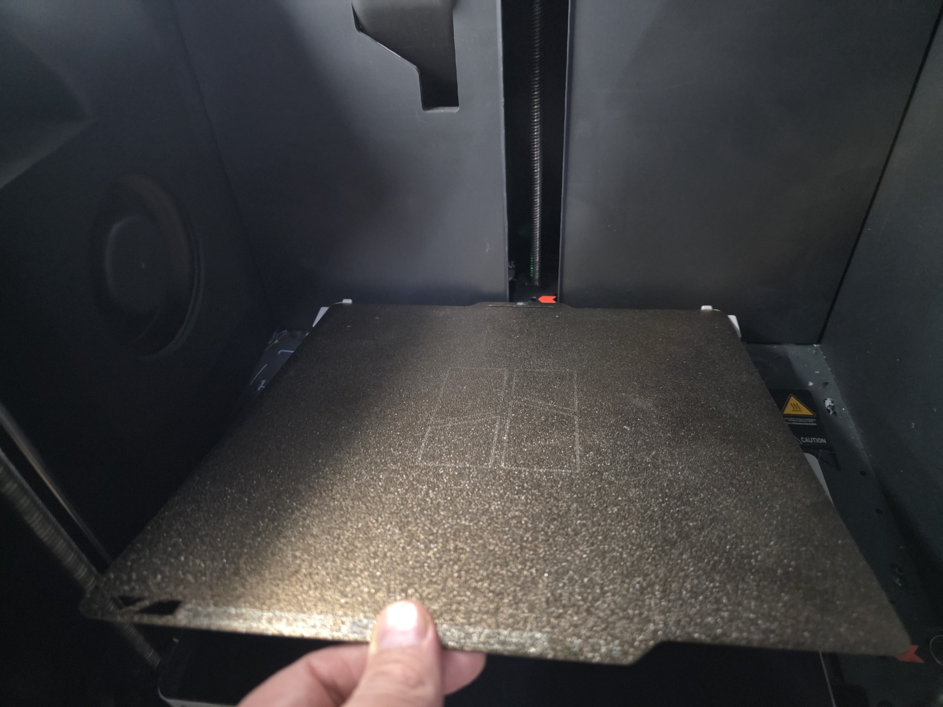

Removing a print

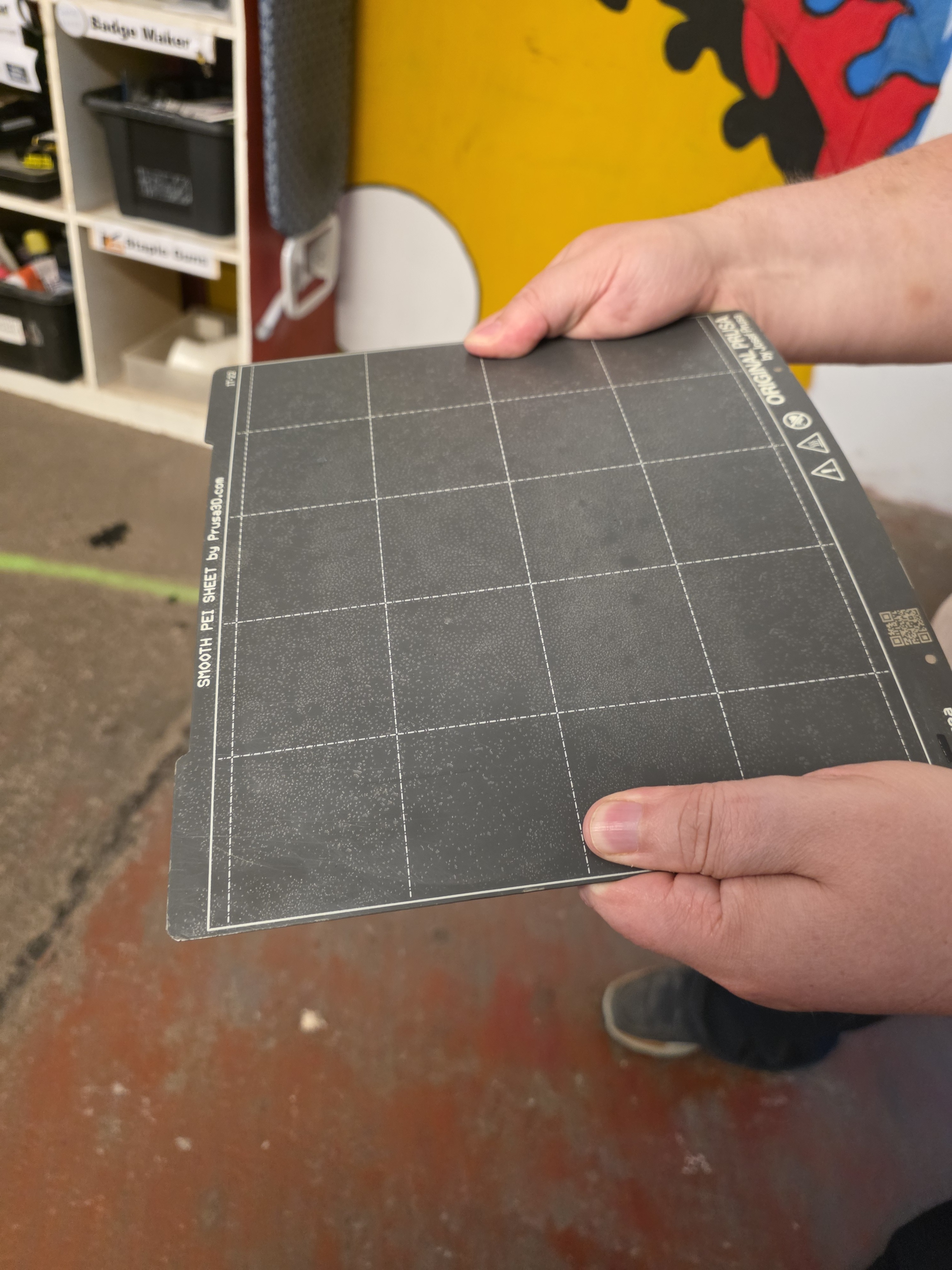

Let the plate cool where possible. Remove the magnetic plate from the printer, point it away from people and flex it gently until the print releases. Do not flex it on the printer and do not use excessive force.
If a scraper is needed, use a plastic scraper only. Do not use metal scrapers on the build plate.
If the print remains stuck, allow more cooling and ask for help. Remove loose plastic, check that the plate is clean and dry, and refit it squarely while keeping fingers clear of the magnets.
Lifting a removable build plate from the printer
Remove the flexible build plate before trying to release the print.
Flexing a build plate to release a print
Flex the plate gently, pointing it away from yourself and other people.
Bambu build plate being refitted
Refit the build plate squarely and make sure it is seated correctly before printing.
