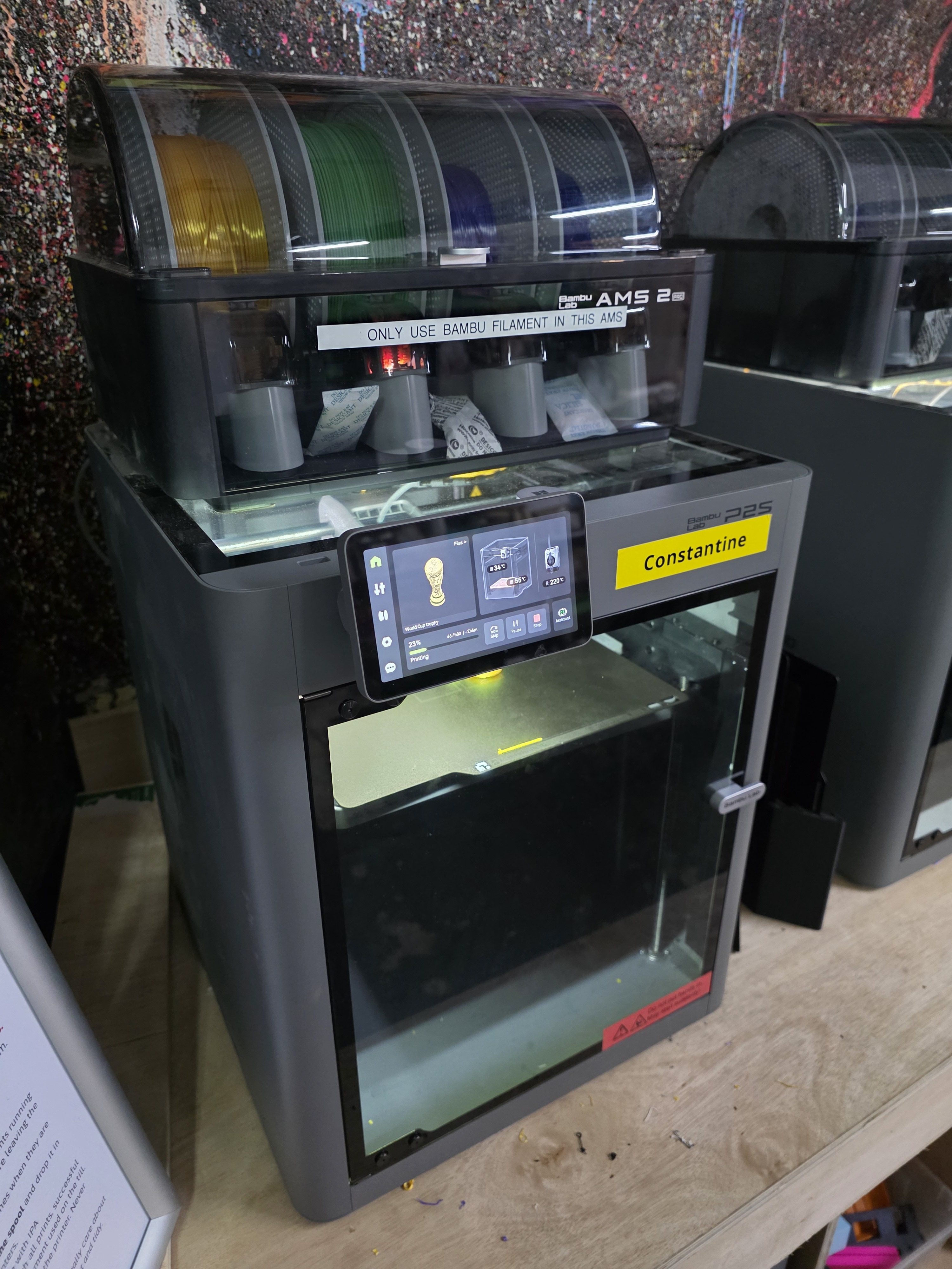

HacMan Bambu P2S with AMS 2 Pro
A HacMan Bambu P2S fitted with an AMS 2 Pro.

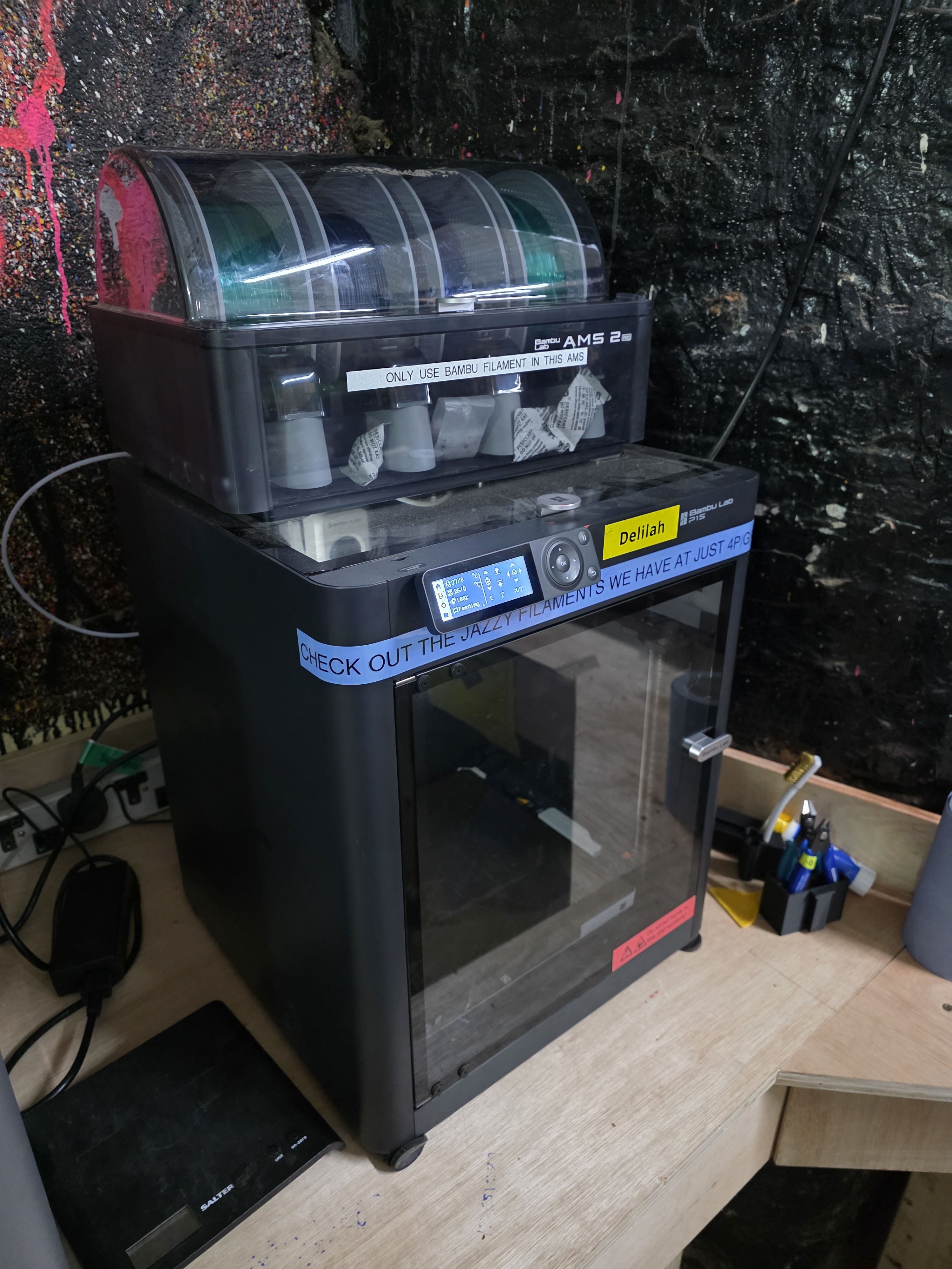

HacMan Bambu P1S with AMS 2 Pro
The HacMan Bambu P1S fitted with an AMS 2 Pro.
