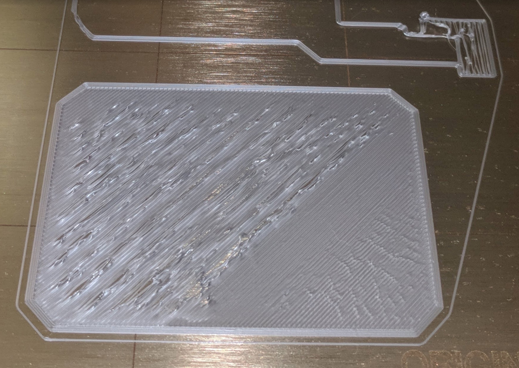

Poor first layer example
A poor first layer should be stopped and investigated before trying again.
Stop the print. Do not push a moving print back onto the plate. If plastic has collected around the nozzle or print head, stop using the printer and ask for help.

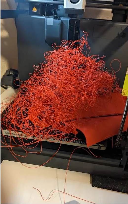

Spaghetti failure on a 3D printer
Spaghetti failures should be stopped promptly.

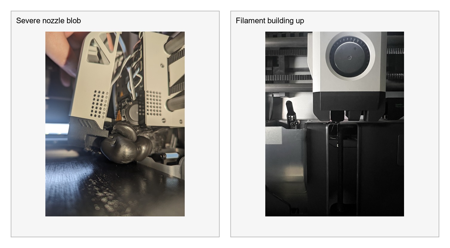

Filament build-up around a nozzle
If filament builds up around the nozzle or print head, stop and ask for help.

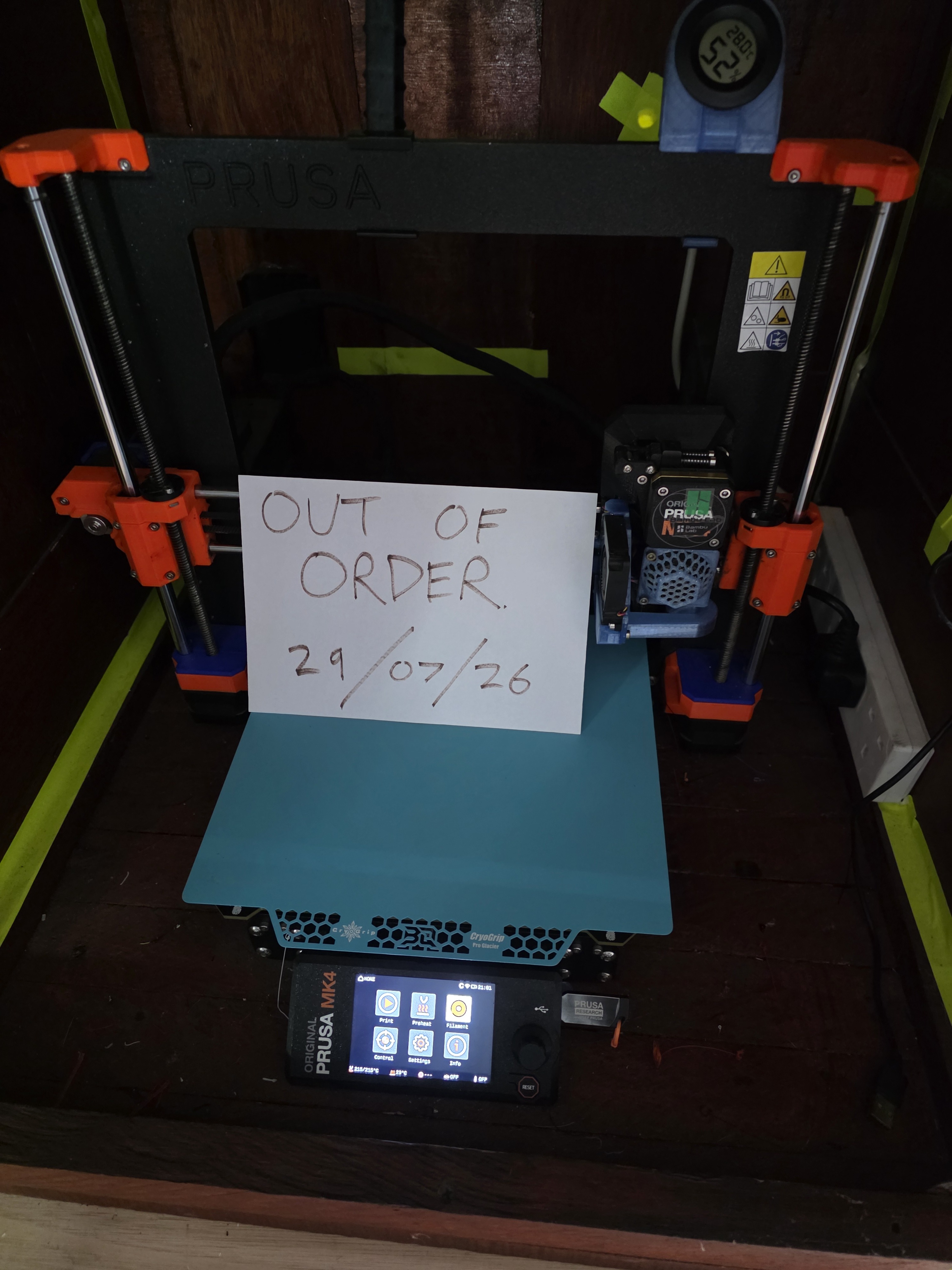

Out-of-order sign on a Prusa MK4
Do not use printers marked out of service.
