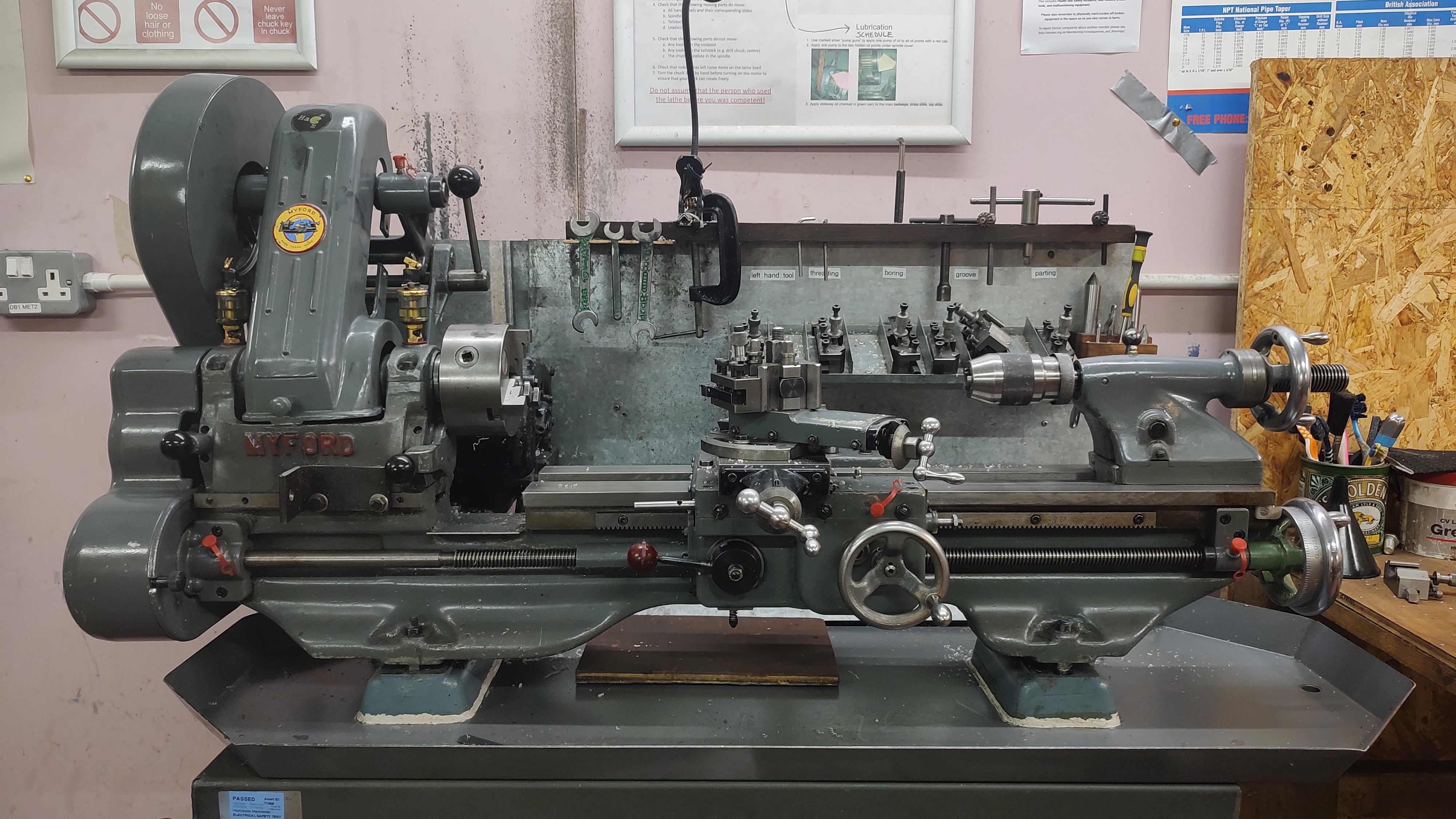

Myford ML7

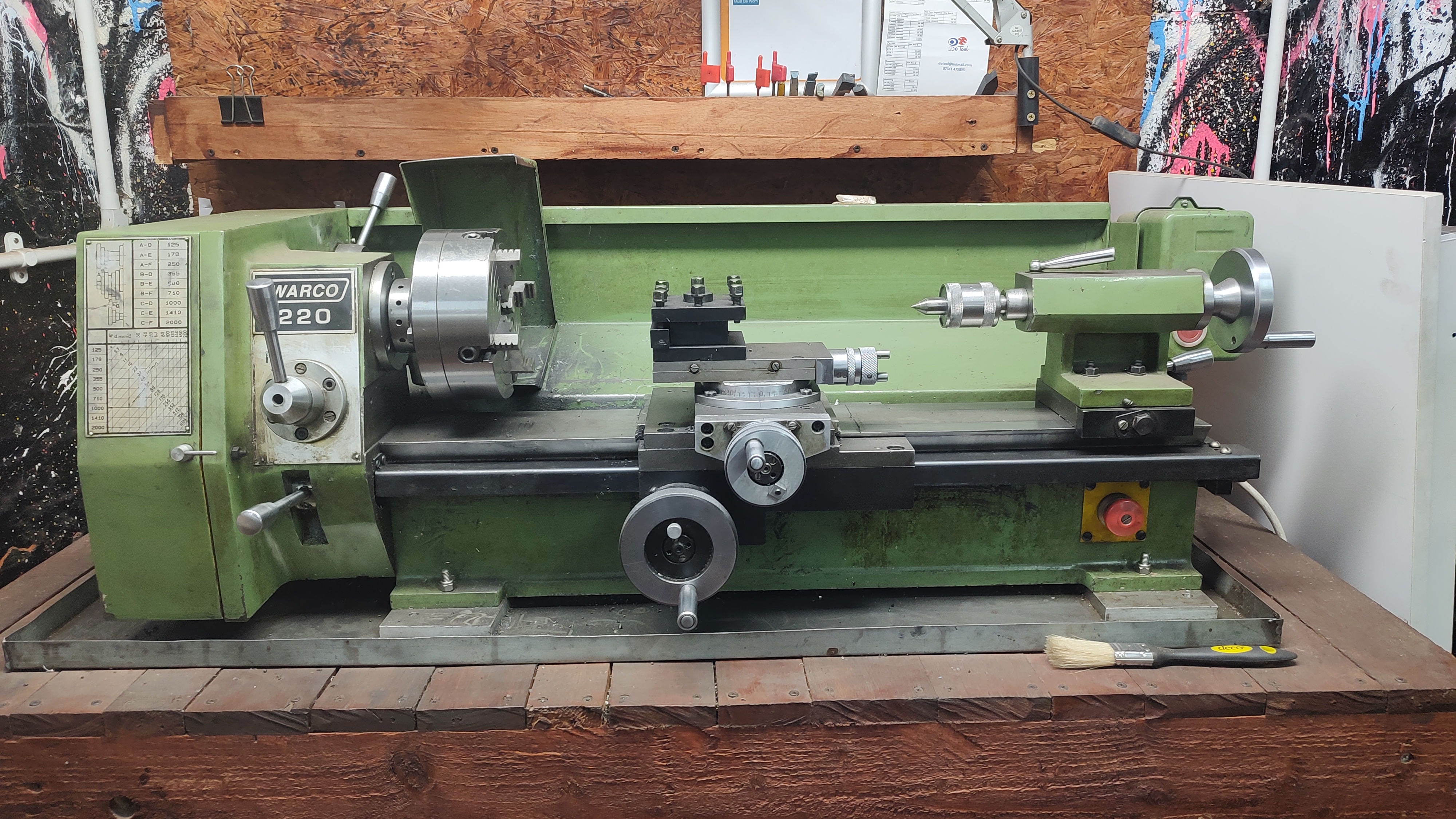

Warco 220

The Myford ML 7 lathe was manufactured in the 1940's as a light machining and model lathe. The lathe has the space to take a roughly 5" diameter by 20" length piece of work.
This machine is ONLY for metalwork, and should only be used by people who have been trained.
Lubrication (Myford)

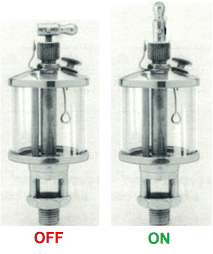

  • When first starting to use the lathe, the oil containers on top need to have the levers on the top put in the upright position to let the oil start to flow. These need to be closed off after you have finished using the lathe by placing them in the laying-down position.
  • There are 13 points that should be oiled as required. Most of these have red plastic caps on. Use single pump from the silver oil pump gun to force oil into these points. This is shown during inductions.
  • Lubricate the slideways if necessary using the green can.
