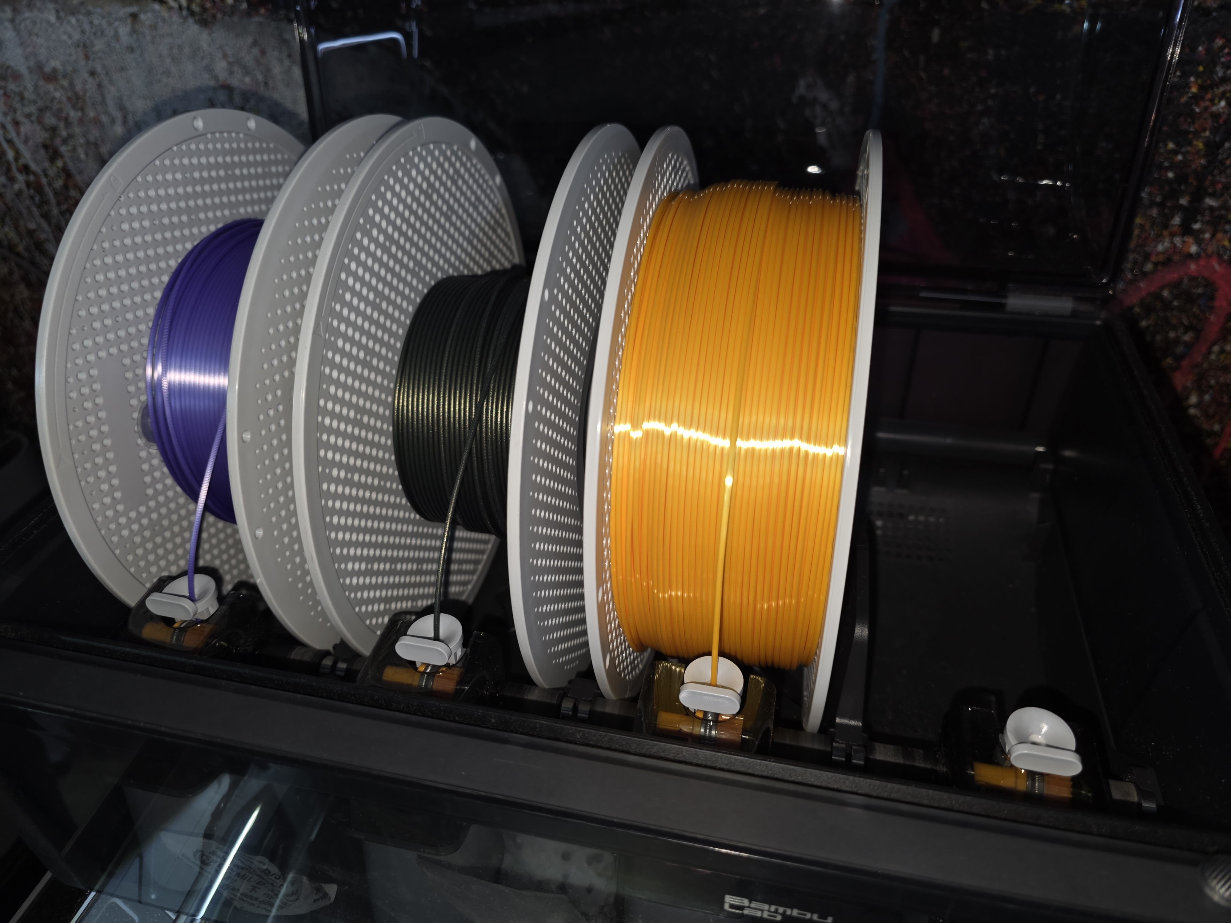

AMS 2 Pro loaded with spools
The AMS 2 Pro feeds filament to the Bambu printers. Spools must sit correctly and rotate freely.

  1. Open the AMS lid.
  2. Place the spool in an empty slot so that it can rotate freely, with the filament feeding over the top of the spool towards the inlet.
  3. Cut the filament end cleanly.
  4. Gently push the grey feeder tab at the front of the slot.
  5. Feed the filament into that slot's inlet until the AMS detects it and starts loading.
  6. Stop pushing once the AMS motor has gripped the filament.
  7. Confirm the material and colour shown on the printer or in Bambu Studio before printing.
  8. Bambu RFID spools can populate this automatically. If using another brand, set or check the slot information manually rather than assuming the previous material and colour are still correct.
  9. Close the AMS lid before starting the print.

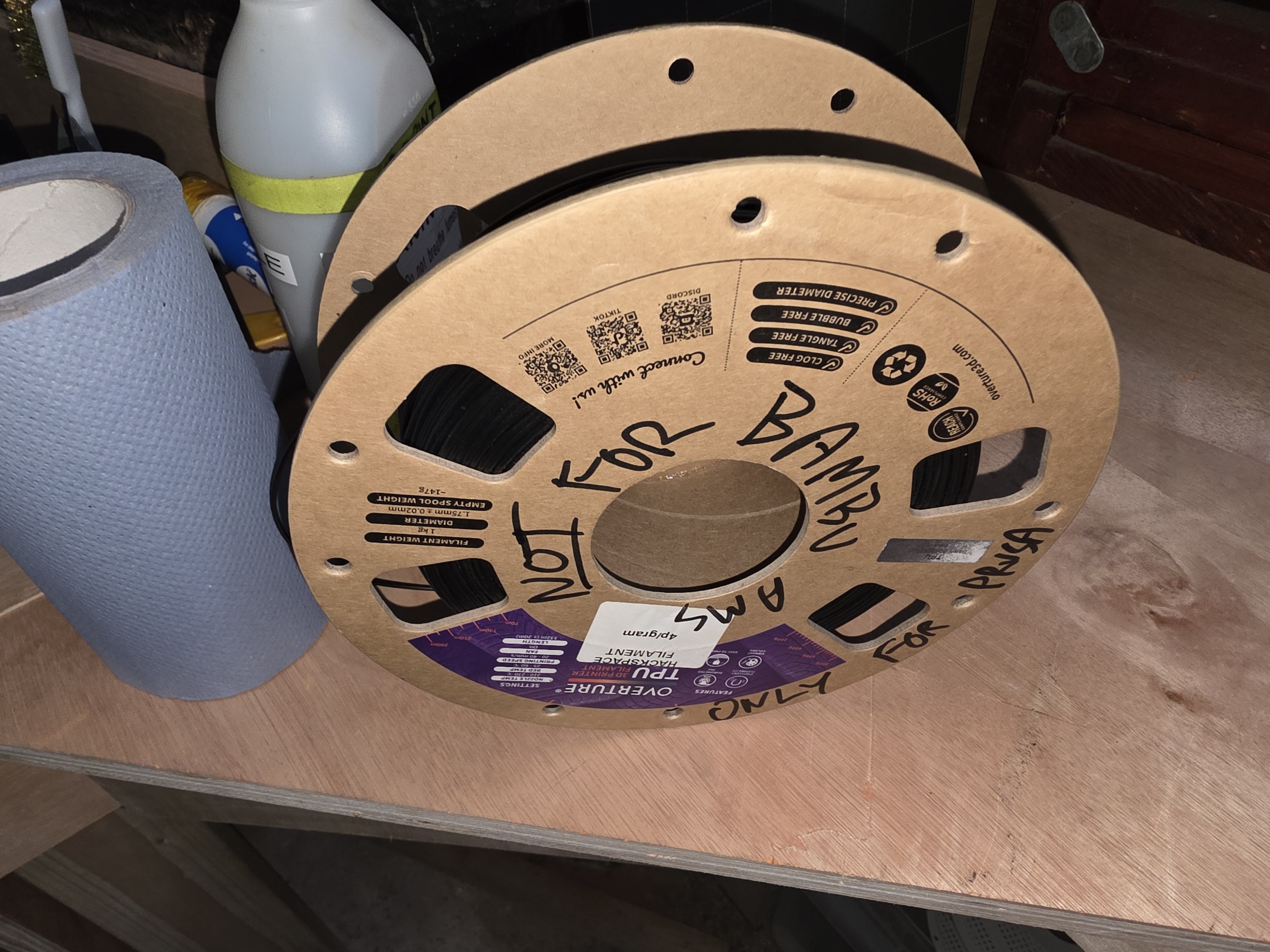

Bare cardboard spools must not be used directly in an AMS. Transfer the filament to a suitable plastic spool or fit approved adapter rings.
TPU must only be used in the AMS if it is specifically marked as suitable for AMS use. Standard flexible TPU should be printed without the AMS to avoid feed problems and clogs.

TPU cardboard spool labelled not for AMS
Do not use bare cardboard spools in the AMS. Flexible TPU should only be used in the AMS if specifically marked as AMS-compatible.

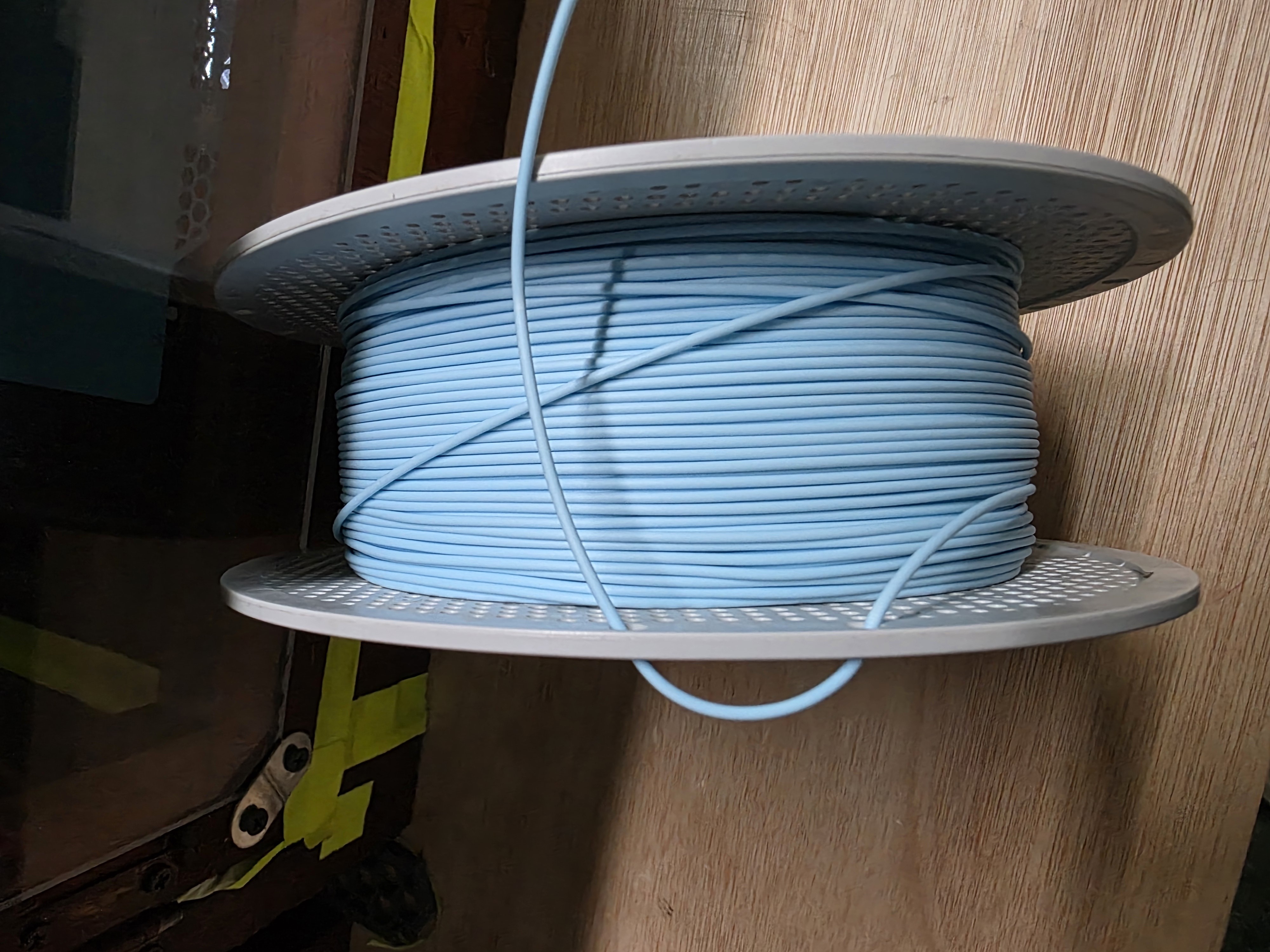

Filament end secured for storage
Secure the free end immediately after unloading filament to prevent tangles.
