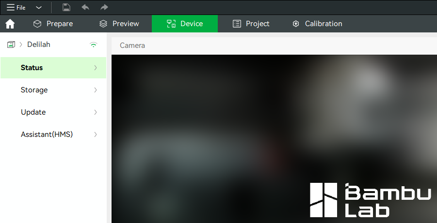

Bambu Studio Device page printer selector
On the Device tab, the current printer is shown on the left. Click the arrow next to the printer name to open the printer list.

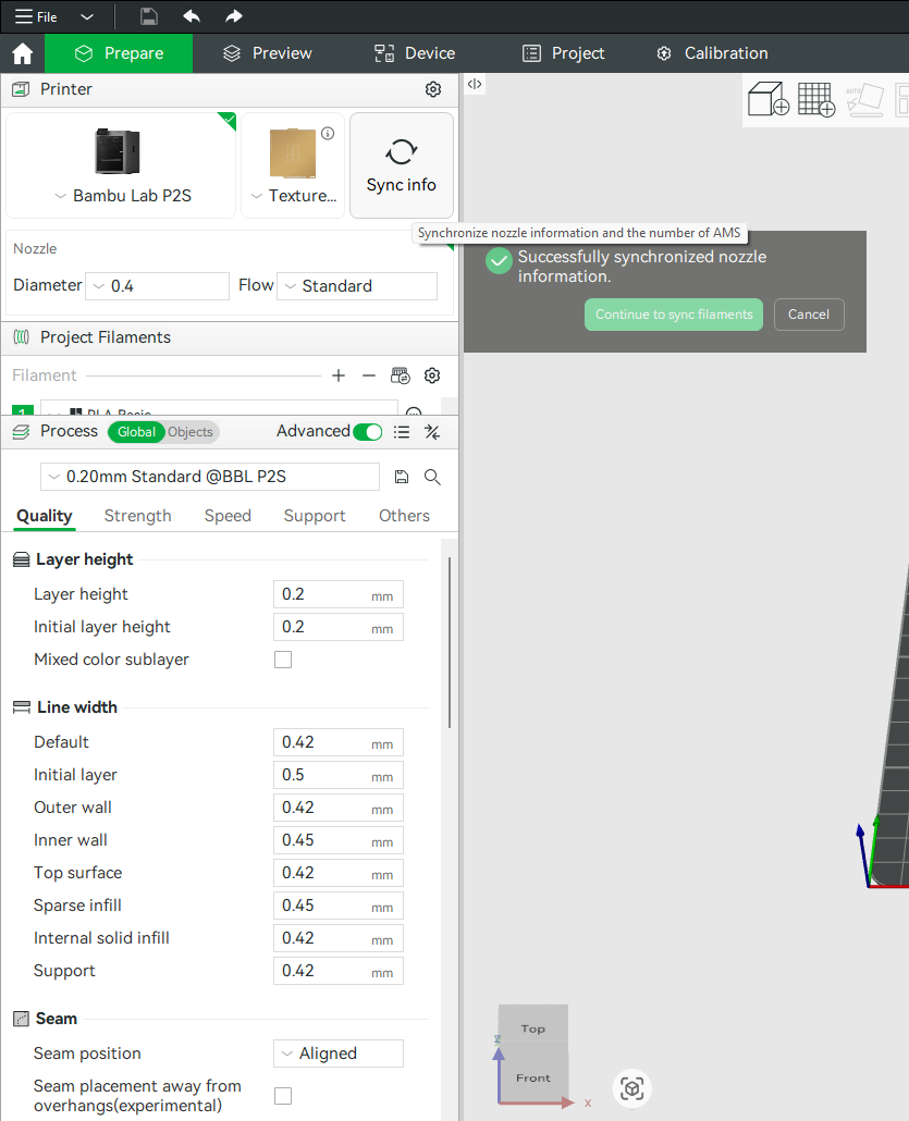

Bambu Studio Sync info prompt
Use Sync info to synchronise printer, nozzle and AMS information. After nozzle information is synced, continue to sync the AMS filaments.

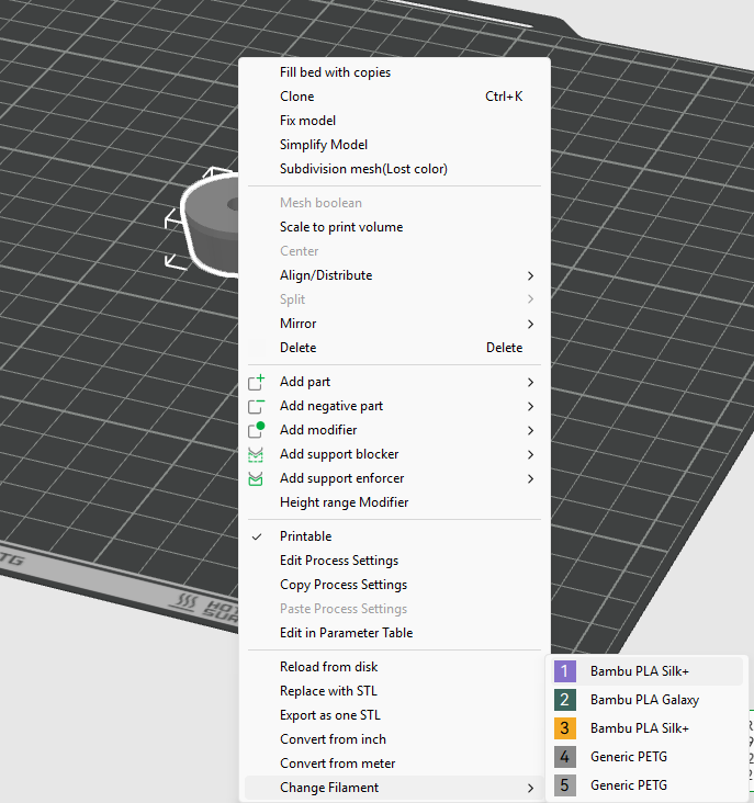

5. Select which filament prints the model
Synchronising makes the filaments available to the project; it does not necessarily assign the desired one to each model.
For a single-colour model:
  1. Select the model on the plate or in the Objects list.
  2. Use its filament/colour control, or right-click and choose Change filament.
  3. Select the numbered project filament that matches the material and colour you want.
  4. Confirm that the model changes to the selected filament colour in Prepare.
For a plate containing separate objects, select each object and assign its filament in the same way. Do not use colour painting for an ordinary single-colour object.
Before slicing, check the material name as well as the colour. Two spools can look similar but require different temperatures.
📌 HacMan rules: Do not put bare cardboard spools in the AMS. ABS and ASA may only be printed on the enclosed Bambu printers. Metal-filled filament is prohibited.
Bambu Studio Change Filament menu
Right-click an object and use Change Filament to choose which AMS slot or material that object should print with.

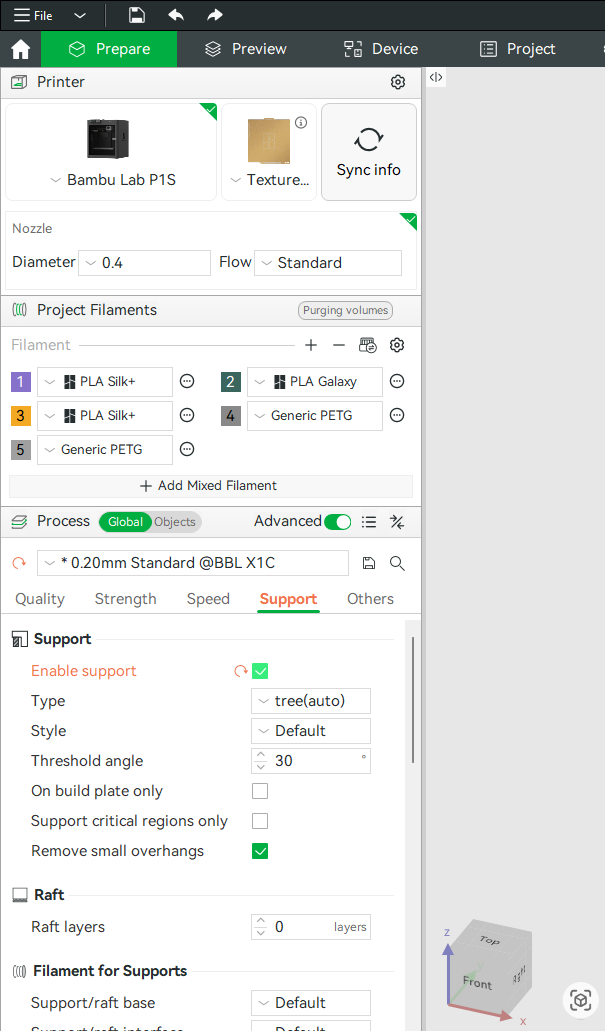

Bambu Studio support settings
Support settings are under the Support tab. Supports are used when parts of the model would otherwise print into mid-air.

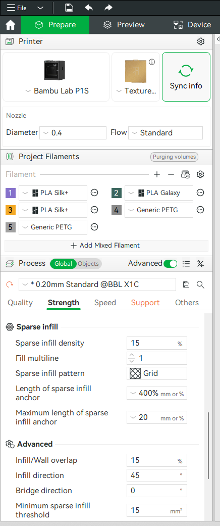

Bambu Studio infill settings
Infill settings are under Strength. Higher infill can make some parts stronger, but wall thickness often matters more.

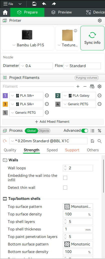

Bambu Studio wall loops settings
Wall loops are under Strength → Walls. Increasing wall loops often improves part strength more effectively than simply increasing infill.

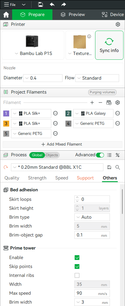

Bambu Studio brim and skirt settings
Brim and skirt settings are under Others → Bed adhesion. A brim can help small or narrow parts stay attached to the build plate.

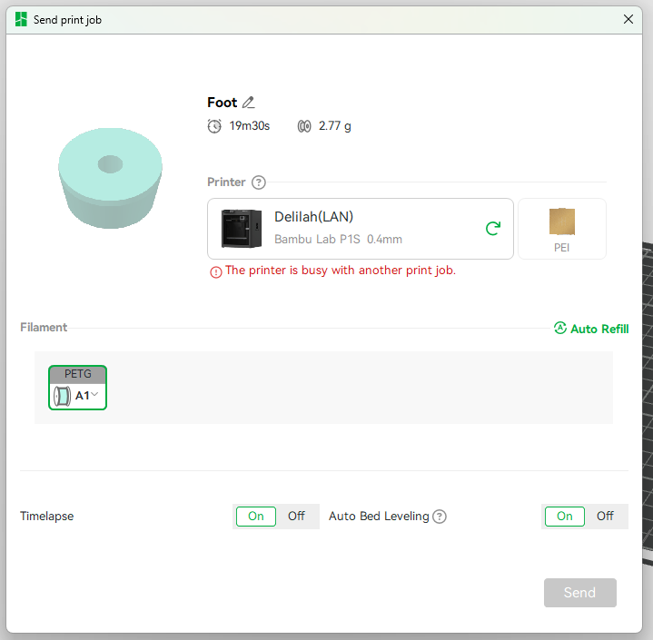

13. Map project filaments to physical AMS slots and send
Select Print plate. In the send dialog:
  1. Choose the intended physical HacMan printer.
  2. Confirm the build plate type.
  3. In the filament-mapping area, match each project filament used by the sliced model to the correct physical AMS slot. The material types must be compatible; check both the slot number and material name.
  4. Review the displayed time, weight and thumbnail.
  5. If a filament is shown as Unmapped, do not send the job. Correct the project filament, load the required material, or choose the correct compatible AMS slot.
  6. Send the job only when every item is correct.
If the intended printer is unavailable, out of service or already in use, cancel the send operation.
Bambu Studio send print job dialog
Before sending, check the printer, plate type and filament. Bambu Studio may ask you to allocate a filament here and will only offer compatible material types for the model.
