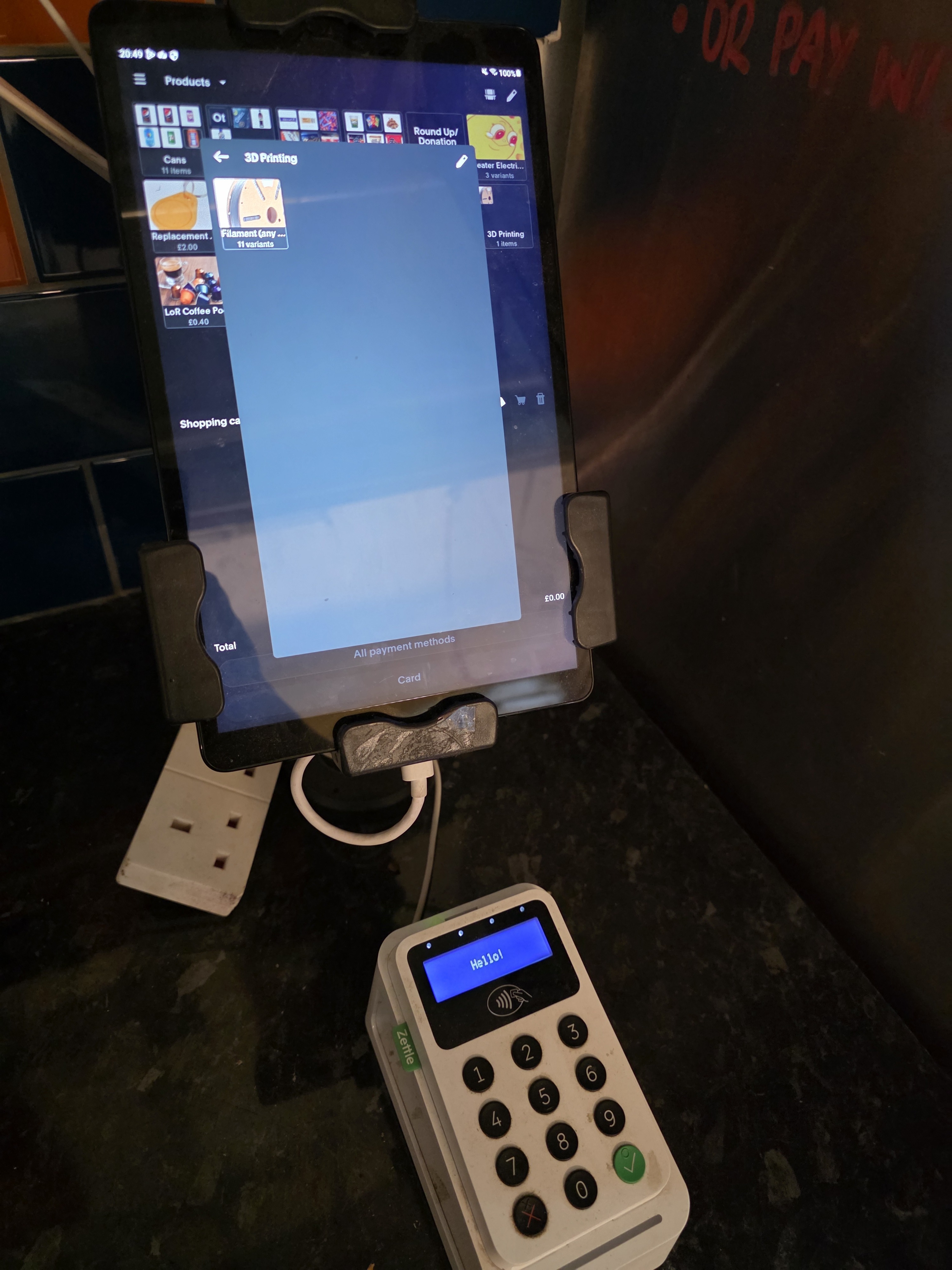

Hackspace till close-up
Pay for Hackspace filament through the Snackspace tuck shop.
