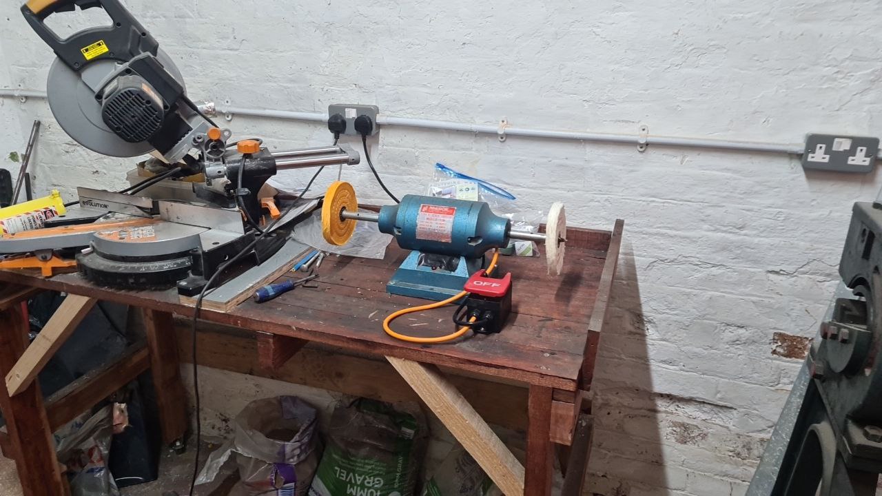

The polisher is a 1/2HP Naerock benchgrinder with two wheels attached.
- 240V / 3A / 3000 RPM
- The type of wheels listed as compatible on the label is 6" x 3/4" x 1/2"
- This is 6" Diameter, 3/4" thick with a 1/2" Arbor
Wheels
There are two wheels mounted a white one which is softer and a yellow one which is harder.
One approach is to apply the polish using the yellow one, then buff it out with the white one.
To remove polish from the sheels use a flat bladed screwdriver.

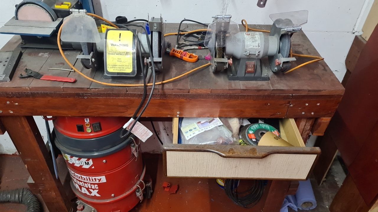

Currently they're being stored in this draw along with the spare wheel
