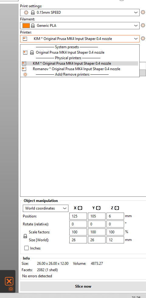

2. Select the printer
In the printer selector, choose the HacMan profile for the correct Prusa MK4 with 0.4 mm nozzle.
⚠ Check: Never slice for a different printer or nozzle size. The virtual plate should match the printer you intend to use.
PrusaSlicer physical printer selection
Select the correct HacMan Prusa MK4 physical printer before slicing or sending a print.

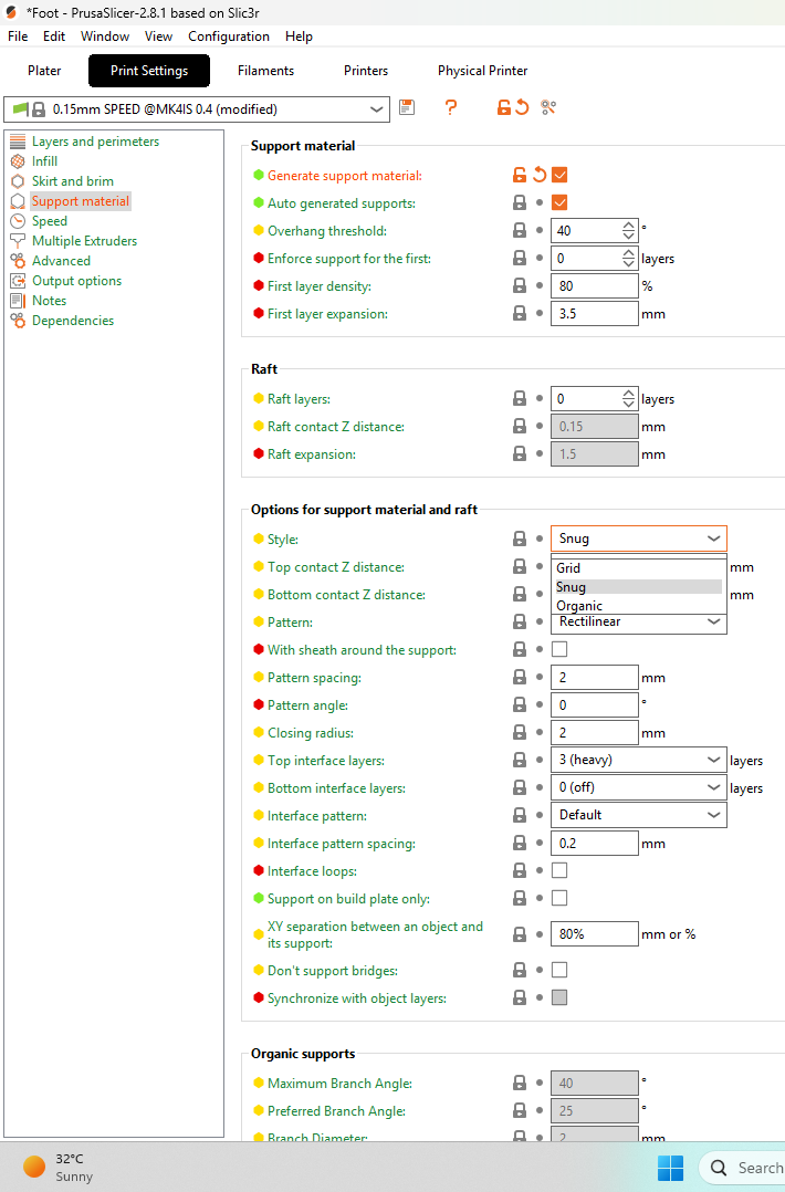

6. Decide whether the model needs supports
Each printed layer must be supported by the build plate or by plastic beneath it. An overhang is a part that extends sideways beyond the layer below. A gentle slope may print without help, but a steep overhang or a feature beginning in mid-air may need temporary support material.
First consider rotating the model so fewer areas need support. If support is still required, enable Generate support material. For a straightforward model, start with On build plate only; use Everywhere only when an overhang cannot be reached from the plate.
Supports consume extra filament, increase print time and can mark the supported surface. Inspect them in Preview and ask for help if they appear inside a cavity where they will be difficult to remove.
PrusaSlicer support material settings
Support settings are in Print Settings → Support material. Supports are used when a model has overhangs that would otherwise print into mid-air.

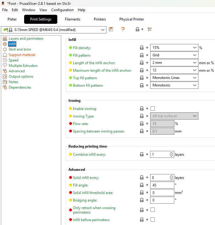

7. Choose infill and wall thickness
Infill is the internal structure inside a model. It supports top surfaces and helps resist crushing, but more infill also uses more filament and time.
  • 15% infill is a sensible starting point for most decorative and lightly loaded parts.
  • Increase it when the part must resist compression or needs more internal support.
  • 100% is rarely necessary and is not automatically the strongest or best choice.

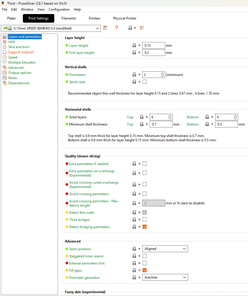

The outer shell is formed from perimeters, also called walls. Adding walls is usually more effective for general strength than greatly increasing infill:
  • use the standard profile for ordinary models;
  • try 3–4 perimeters for a stronger functional part; and
  • remember that print orientation matters: layer-to-layer strength is usually the weakest direction.
PrusaSlicer infill settings
Infill settings are in Print Settings → Infill. Fill density controls how much internal structure the print has.
PrusaSlicer layers and perimeters settings
Perimeter settings are in Print Settings → Layers and perimeters. Increasing perimeters is often a good way to improve part strength.

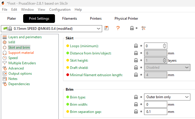

8. Add a brim when needed
A brim is a thin, single-layer border attached to the bottom edge of the model. It increases contact with the plate and can help narrow, tall or corner-prone models stay attached.
Use a brim when the model has a small footprint or is likely to lift. It must be removed after printing and may leave a small edge to tidy, so it is unnecessary for a broad, stable model that already adheres well.
PrusaSlicer skirt and brim settings
Skirt and brim settings are in Print Settings → Skirt and brim. A brim can help small or narrow parts stay attached to the build plate.

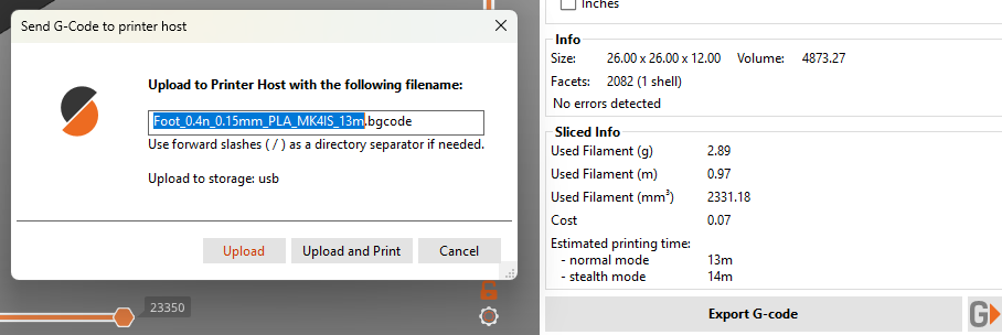

11. Send the job from a HacMan PC
On a HacMan PC, select the required machine from the Physical printer selector. After slicing and checking Preview, press the G button in the bottom-right corner to send the G-code to that printer.
Confirm that the physical printer name is correct before sending. Do not send to a machine that is already in use or marked out of service. At the printer, check that the received filename, thumbnail and estimated time match the intended job before starting it.
PrusaSlicer G button send dialog
On the Hackspace PCs, once a physical Prusa printer is selected, use the G button in the bottom-right to send the file to the printer.
If the configured network workflow is unavailable, ask another member rather than changing connection settings. USB export may be used if that is the current fallback procedure.
